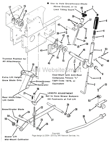

HWG 0 #1 Posted January 22, 2016 I am looking for a manual or even a view of the lift lever ,the shaft ,and the lift attachment bar ...I hooked up a snow blower and when I got it picked up it would not latch and after a big yank ...it is like the shaft may have spun inside the attachment lifting piece...is there a key way or dirt pin that locates it ? Share this post Link to post Share on other sites
daveoman1966 3,882 #2 Posted January 22, 2016 This should be the lift schematic.... Manual lift for 300 400 and 500 series are all about the same 1 Share this post Link to post Share on other sites
HWG 0 #3 Posted January 22, 2016 thanks very much ....looks like there is a key way in the shaft ...sorry to ask but have like page 2 with the item parts list? Share this post Link to post Share on other sites
gwest_ca-(File Mod) 12,009 #4 Posted January 22, 2016 Don't know your model and year so here are all of them. https://www.partstree.com/parts/search/models/?searchTerm=416-8 Open the correct year and then the "Manual Lift Linkage" page. Garry Share this post Link to post Share on other sites
