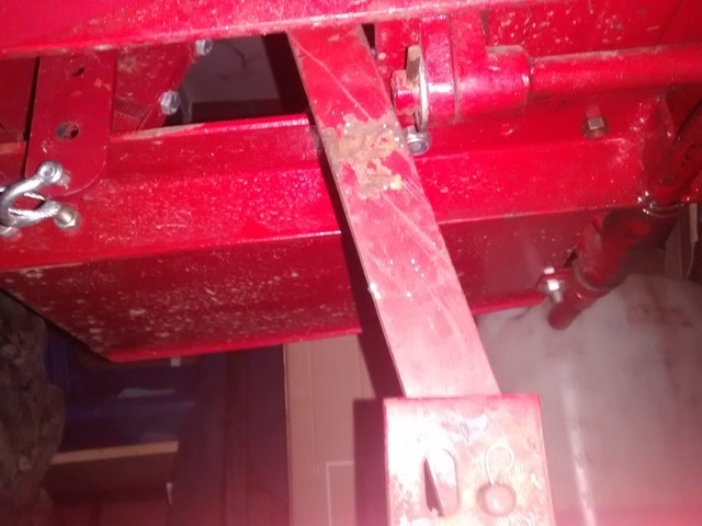

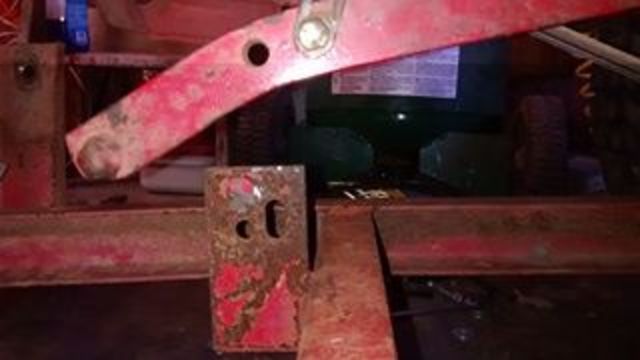

oldlineman 1,654 #7 Posted January 18, 2016 (edited) Thanks graig I took a pic. but not sure how to post, mine however has a link att. to the long hole on the plow for some movment up an down thanks for the help. The link is about 5 in. long, holes are spaced 3 1/2 in. bottom hole is slotted , 1/4 in. dia. and made out of 1/4 thick steel. Hope this helps you. Edited January 18, 2016 by oldlineman 2 Share this post Link to post Share on other sites
ericj 1,579 #8 Posted January 18, 2016 10 minutes ago, oldlineman said: Thanks graig I took a pic. but not sure how to post, mine however has a link att. to the long hole on the plow for some movment up an down thanks for the help. The link is about 5 in. long holes are spaced 3 1/2 in. , 1/4 in. dia. and made out of 1/4 thick steel. Hope this helps you. that's what i was trying to describe, you can put it in the slotted hole on the plow to allow for some play or you can mount it in the single hole thanks oldlineman for posting the picture eric j Share this post Link to post Share on other sites

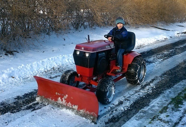

Tankman 3,528 #16 Posted January 19, 2016 (edited) Made a few short solid links. Used 5-1/2" x 1-1/2" x 1/4" thick steel flat bar. Two 3/8" dia clearance holes 4" OC (on center). Use 3/8" clevis pins and hair pin cotters. With todays weather report, pulled out a set of chains for my 520-8. Grandsons pray for snow. Should they be spanked? Pic is one dope on our 416-8 enjoying white, cold, wet, nasty junque! How dare him! PS. When done we back the Horses into the barn up on 2 x 6's, tires and blade. White junque melts to the concrete deck. WD (water displacement) 40 or oil is applied to top edge of the scraper, stops rust. Hardware on our blades is stainless steel installed with Never-Seez. Edited January 19, 2016 by Tankman 1 Share this post Link to post Share on other sites
