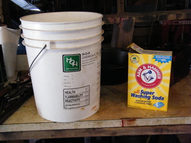

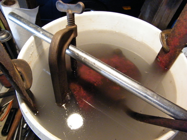

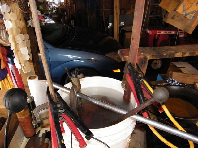

stevasaurus 23,807 #61 Posted January 29, 2016 Electrolysis...got a few warmer days coming up, so I decided to get that rusty case going in the tank. Here is a link that I like that really explains the process... http://www.rickswoodshopcreations.com/miscellaneous/rust_removal.htm Got my bucket and my washing soda. I put in a good 1/2 cup and mixed in the water. The Anodes are "C" clamped to the sides of the bucket...about 1/2" off the bottom. The transmission casing is also "C" clamped and is just hanging on a bar to keep it from moving around. Then it is just a matter of hooking up the wires from the battery charger. The black clip goes on the part to clean and the red clip goes on the sacrificial anode. I then took some jumper cables and attached between the 2 sacrificial anodes. The charger is set on 10 amps. Watching an E-tank can be better then watching paint dry. 7 Share this post Link to post Share on other sites

stevasaurus 23,807 #63 Posted January 29, 2016 They are 2 scrape blades from snow blades. I could have cut them in half,or maybe 1/3rds, but I wanted to get this going. It is still January. 1 Share this post Link to post Share on other sites
squonk 47,912 #64 Posted January 29, 2016 I thought they had to be 2 dissimilar metals. Share this post Link to post Share on other sites
stevasaurus 23,807 #65 Posted January 29, 2016 Not at all. You want ferrous metals in all parts of this operation. It is all about electrons moving from negative to positive. Different metals can make the solution toxic. 3 Share this post Link to post Share on other sites

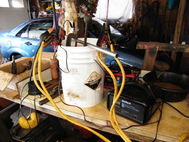

stevasaurus 23,807 #69 Posted January 29, 2016 Absolutely, before, during and after pictures will be shared. And Gernzz8, feel free to ask any questions. WHX^ (Jim), it's Steve...OK, my wife spelled Stevasaurus. If you look at the pictures, I have an anode on each side of the case...both are starring at the rust. I do have a problem though, I may have ruined my 10 amp charger...not on this...I was trying to jump start my 876 last week, and I must have over cranked it. I saw a spark from inside the charger and unplugged it immediately. It might be a fuse...anyway, I bought a new one at Harbor Freight, but the power does not go to the clips unless the unit recognizes a battery of a certain voltage when hooked up. Dang I hate OHSA!! The new charger does not work in the electrolysis process...........unless I can fool it into thinking I have a battery in place. I am thinking that I may have to put the charger on a battery and then run wire to the electrodes on the E-tank. That is tomorrow. 1 Share this post Link to post Share on other sites
JPWH 6,544 #70 Posted January 30, 2016 Stevasaurus, most likely the battery cable melted. I have done the same thing to my charger 2 times. The last time I put trolling motor cables which are a couple sizes larger and no more problems. Hank 1 Share this post Link to post Share on other sites
C-101plowerpower 1,606 #71 Posted January 30, 2016 1 hour ago, stevasaurus said: Absolutely, before, during and after pictures will be shared. And Gernzz8, feel free to ask any questions. WHX^ (Jim), it's Steve...OK, my wife spelled Stevasaurus. If you look at the pictures, I have an anode on each side of the case...both are starring at the rust. I do have a problem though, I may have ruined my 10 amp charger...not on this...I was trying to jump start my 876 last week, and I must have over cranked it. I saw a spark from inside the charger and unplugged it immediately. It might be a fuse...anyway, I bought a new one at Harbor Freight, but the power does not go to the clips unless the unit recognizes a battery of a certain voltage when hooked up. Dang I hate OHSA!! The new charger does not work in the electrolysis process...........unless I can fool it into thinking I have a battery in place. I am thinking that I may have to put the charger on a battery and then run wire to the electrodes on the E-tank. That is tomorrow. connect a couple of jumpers to a good battery until the charger starts, then take the jumpers back of and you're sorted. unless i'm wrong and you'll have to leave that battery in the loop 1 Share this post Link to post Share on other sites
Racinbob 13,113 #72 Posted January 30, 2016 1 hour ago, stevasaurus said: Absolutely, before, during and after pictures will be shared. And Gernzz8, feel free to ask any questions. WHX^ (Jim), it's Steve...OK, my wife spelled Stevasaurus. If you look at the pictures, I have an anode on each side of the case...both are starring at the rust. I do have a problem though, I may have ruined my 10 amp charger...not on this...I was trying to jump start my 876 last week, and I must have over cranked it. I saw a spark from inside the charger and unplugged it immediately. It might be a fuse...anyway, I bought a new one at Harbor Freight, but the power does not go to the clips unless the unit recognizes a battery of a certain voltage when hooked up. Dang I hate OHSA!! The new charger does not work in the electrolysis process...........unless I can fool it into thinking I have a battery in place. I am thinking that I may have to put the charger on a battery and then run wire to the electrodes on the E-tank. That is tomorrow. Yupper dupper Steve. That's what I have to do. You might get away with what Koen mentioned but I'm doubting it. I just parallel in a trolling motor battery and I'm good to go. I use it because it's available but you don't need any real capacity. The charger just wants to see a battery. You won't have much current draw with what you can fit in a 5 gallon bucket. My battery will take a full charge and cycle the charger on and off as I'm using it on the tank. 1 Share this post Link to post Share on other sites
WNYPCRepair 1,924 #73 Posted January 30, 2016 I'm sure you have some batteries around that could use a charge anyway. I know I do. 1 Share this post Link to post Share on other sites

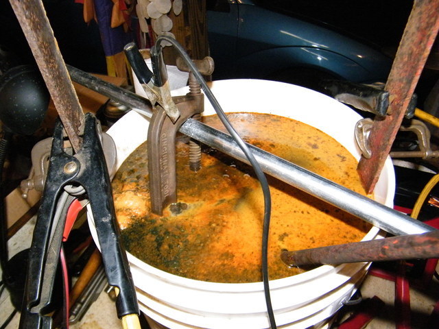

stevasaurus 23,807 #74 Posted January 30, 2016 Well I opened up my charger, and I did not really see anything wrong...nothing burnt, nothing scorched. I checked my Multi-meter and found I had blown a fuse...I replaced the fuse and found that the charger was putting out the usual 12 volts and 10 amps. So, I hooked her back up and I started to see bubbles (that is a great sign)...you should start to see bubbles by the anode almost right away. I did not see them yesterday. I am thinking that there was enough oil on the casing yet to make Electrolysis hard to do...after soaking all night enough of the oil came off the case to make current work. I am not sure about any of this, but it is now working. This picture is after about 5 hours of the bubbles starting. This is what you want to see. This nice orange oxidation floating on the surface. This is rust coming from the casing. 5 Share this post Link to post Share on other sites
