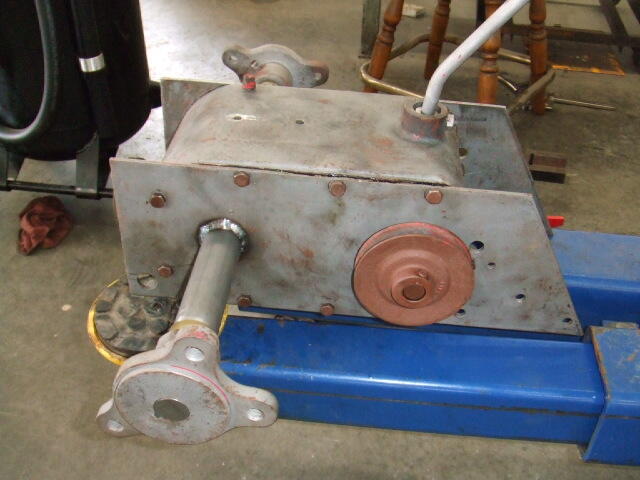

TheGrinch 7 #229 Posted August 19, 2023 I just finished one for my friend Tim (VT Tim) thanks to Steve and others info here it was a breeze except for a couple of issues. The pictures of the bearing installation in an early post was wrong and of course I installed the bearings in the wrong places so I ruined them getting them back out with the welder lol. The original early seal style axle tubes are quite a bit longer than the later ones with the outer type axle seal. I replaced his and had to trim them quite a bit, I forget how much. After about 10 beers I got all of the gears in correctly. Ground Bearing R12https://www.mcmaster.com/60355K185/ Un-ground Bearinghttps://www.mcmaster.com/6383K49/ Outer Tube Bushingshttps://www.mcmaster.com/6391K726/ 1 Share this post Link to post Share on other sites

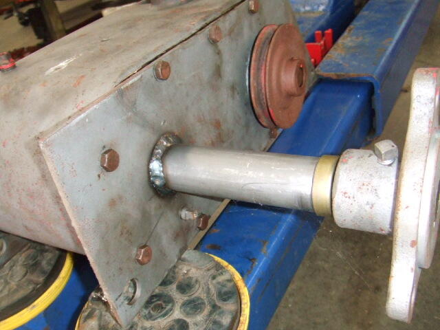

Keaton 466 #230 Posted July 1, 2024 how did you get the hubs off the trnasmission i almost got one Share this post Link to post Share on other sites
Handy Don 17,571 #231 Posted July 2, 2024 (edited) 19 hours ago, Keaton said: how did you get the hubs off the trnasmission i almost got one Do a search of this site for threads about “pulling hubs” or “hub puller” and you’ll find a lot of information Edited July 2, 2024 by Handy Don 1 Share this post Link to post Share on other sites

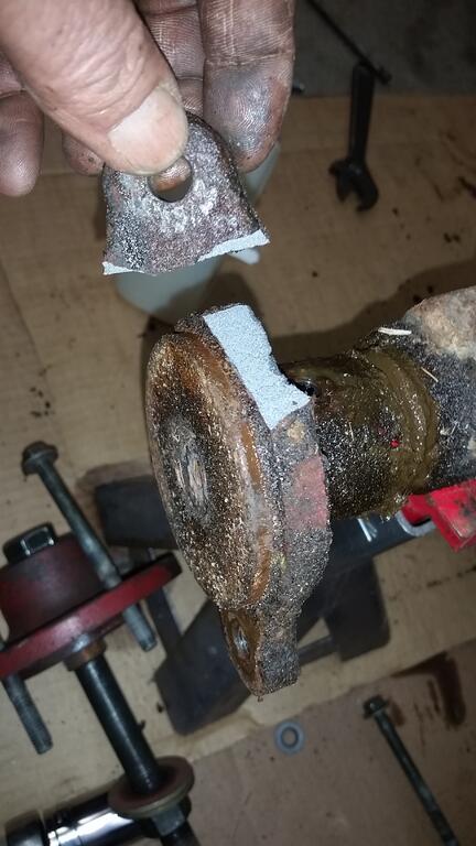

WHX?? 58,307 #232 Posted July 2, 2024 Get a bearing collar on back of them. DO NOT pull by the ears. Ask me how I know. Share this post Link to post Share on other sites
peter lena 10,091 #233 Posted July 30, 2024 @WHX?? https://www.autozone.com/transmission-and-drive-train/pilot-bearing/p/cta-manufacturing-corporation-2-1-4in-bearing-separator/470974_0_0 you want to pull at the strongest fit point , directly at axel connection , not outer flange , also KROIL PENETRANT , days out remove set bolt , rust runs out , like dead blow hammer , to help out initial movement , nothing sarcastic implied , just what works , pete 1 Share this post Link to post Share on other sites
