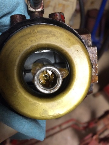

6.0 powerstroke 62 #1 Posted January 17, 2016 My plow machine hasn't seen much (any) use this winter, so I figured while it was warm and I had time I would make sure it would start and run still nope, won't start, check spark, fuel filter is full, fires off ether, and fuel starts dumping out of the carb. I pull the carb off and find a jelly/goo inside the fuel bowl and all up in the jet apparently I put regular gas in over the summer at some point , instead of ethanol free. At least I caught it before I needed it 1 Share this post Link to post Share on other sites
Howie 900 #2 Posted January 17, 2016 I have seen that several times from that ethanol laced gas. Sometimes it seems like it does not have to sit very long either. I showed some I drained out of a mini tiller to the owner who is a farmer, he couldn't believe it until seen. He buys his fuel from the Farm Bureau Co-op because he thinks it sells his grain. David Share this post Link to post Share on other sites
6.0 powerstroke 62 #3 Posted January 17, 2016 This tractor sat quite a bit this year, so I wonder if some moisture got into the fuel too ive seen gunk and crud before , but not this stuff Share this post Link to post Share on other sites
