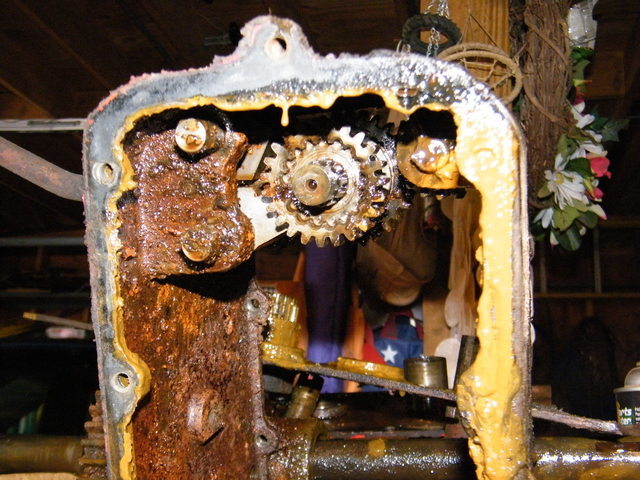

stevasaurus 23,714 #27 Posted January 21, 2016 I think I have an idea what your shifting issue may be. Your 2 shift rails have 3 notches in each one. Your 1st and 2nd gear notches and the neutral notches never see the light of day when using your tractor. The outer notches (reverse and 3rd) are visible outside the shift rail post hole when you are in either 1st or 2nd gear. You said you had water in the trans and that your oil was like cheese wizz. If the horse was sitting for some time, you may have a little rust on the outer ends of those rails...could be why you feel the resistance. If you flushed out the trans and put in fresh oil, you probably just need to use the tractor to wear the little bit of rust off and you will be fine. Maybe do another oil change in the spring or summer. I know yours is not this bad, but it shows what I am talking about. Shift rails are the round thingys on the top left. 1 Share this post Link to post Share on other sites
