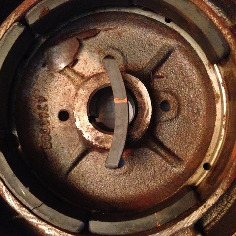

formariz 12,354 #1 Posted January 16, 2016 Picked up a NOS K301 today that it has been on the shelf since the 70's. It had a disturbing rattle under flywheel when moved by hand. Took off flywheel and found that adhesive failed on all but one magnet. One has also cracked in half. It was obviously exposed to some moisture. What is the recommended glue to glue them back into place? Share this post Link to post Share on other sites

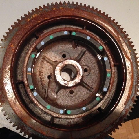

formariz 12,354 #11 Posted January 18, 2016 (edited) Found it. It however just confused me even more. When testing for polarity on magnets I found that these magnets have the same polarity on both ends and the reverse in the center. After a little more research though my literature I found the clarification to my confusion. I had printed this years back from researching some stuff about Tecumseh ignitions. The way it is described on the Kohler site is really not correct as it pertains to the individual magnets.Here is the link to it http://enginesandmagnets.com/id2.html. Here is the end result on my flywheel, blue dots is South, green dots is North. Edited January 18, 2016 by formariz 2 Share this post Link to post Share on other sites
