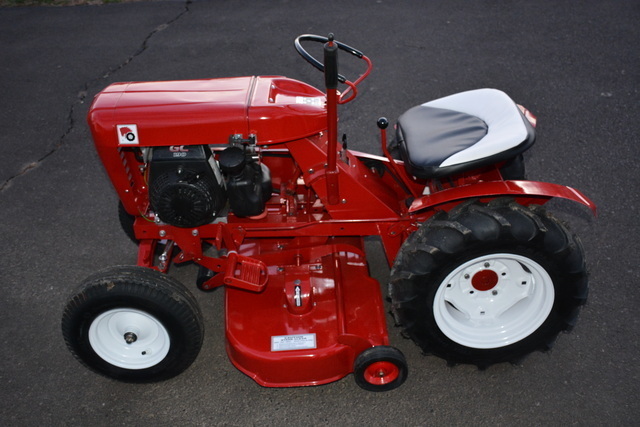

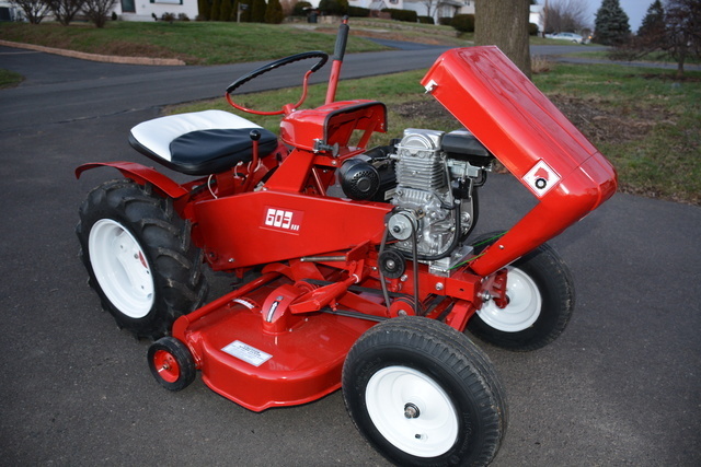

rem722 33 #1 Posted January 16, 2016 Hi Guys, Well after 3 months of hard work here she is. I know its not all original but I made modifications to make it easy to service in the future. The Honda engine and split hood came together nicely. Every bearing and seal and bushing is new. The paint was sprayed on. Hope she cuts grass good after all this work. I was hoping to hear any opinions...... 20 Share this post Link to post Share on other sites

DennisThornton 4,773 #3 Posted January 16, 2016 Wow! Maybe the Ponds should have used your hood design. I'm not a rigid purist, especially when the change is a betterment and I think you found two! I really like it a lot! Would have like to have seen the hood splitting process. 7 Share this post Link to post Share on other sites

AMC RULES 37,259 #7 Posted January 16, 2016 Any picts of the hinge set up to share here? 2 Share this post Link to post Share on other sites
rem722 33 #8 Posted January 16, 2016 17 minutes ago, DennisThornton said: Wow! Maybe the Ponds should have used your hood design. I'm not a rigid purist, especially when the change is a betterment and I think you found two! I really like it a lot! Would have like to have seen the hood splitting process. Thanks Dennis, I basically made my cut on the hood and then used a bead roller. And the Honda 190cc worked out well too. Thank you for the support. 23 minutes ago, Ranger13148 said: That's a great looking job you did there. You should be ecstatic about what you accomplished. Thanks Ranger for the kind words!!! Share this post Link to post Share on other sites
DennisThornton 4,773 #9 Posted January 16, 2016 I've used a flange maker in an impact hammer to create that lip in flat sheet but it would have failed horribly on the rounds. Any issues with the bead roller on the rounded curves? 1 Share this post Link to post Share on other sites
rem722 33 #10 Posted January 16, 2016 33 minutes ago, DennisThornton said: I've used a flange maker in an impact hammer to create that lip in flat sheet but it would have failed horribly on the rounds. Any issues with the bead roller on the rounded curves? Really its just the opposite. The bead roller it extended enough to accept various depths of metal. I c-clamped a "stop" on the roller as to get a 3/8" bead and cranked it slowly. It worked great. Share this post Link to post Share on other sites
SPINJIM 1,997 #11 Posted January 17, 2016 Beautiful work. Great way to get around the hood problem on the 603. I have a Honda GX 160 that I want to put on my 604, and haven't decided how to modify the hood. Hope you don't mind if I copy your idea. I'd love to see some details of how you hinged the hood. How much did you have to raise the engine to have the pulley line up with the belt guard, etc.? Did I miss some earlier pictures of the work in progress? Be very proud of the job you did. It's a shame to cut grass with it. This year's featured model at the WH show in Arendtsville is Customized Horses. Any chance you'll be bringing it there? I agree that 'improved' or 'customized' tractors are more INTERESTING than restored ones. I have some of both. Great job. 1 Share this post Link to post Share on other sites
rem722 33 #12 Posted January 17, 2016 23 minutes ago, SPINJIM said: Beautiful work. Great way to get around the hood problem on the 603. I have a Honda GX 160 that I want to put on my 604, and haven't decided how to modify the hood. Hope you don't mind if I copy your idea. I'd love to see some details of how you hinged the hood. How much did you have to raise the engine to have the pulley line up with the belt guard, etc.? Did I miss some earlier pictures of the work in progress? Be very proud of the job you did. It's a shame to cut grass with it. This year's featured model at the WH show in Arendtsville is Customized Horses. Any chance you'll be bringing it there? I agree that 'improved' or 'customized' tractors are more INTERESTING than restored ones. I have some of both. Great job. If you like this idea, please go ahead and use it. Maybe you can do better. I simply took a measurement of the old engine in place in reference to the frame for the center of the PTO on the engine. Thank you for the kind words, I really thought guys would say I ruined it. Share this post Link to post Share on other sites

jb4249 143 #23 Posted January 17, 2016 I like the hood and how you manager it. I'd like to use your design on my Ranger. Any more pictures and details and or measurements would be appreciated. I guess you have a bead roller? My hood is at the metal cleaner now, waiting for it to come back. They are adding 2.5" to the length. hinging the front is a good idea. Ted 1 Share this post Link to post Share on other sites
