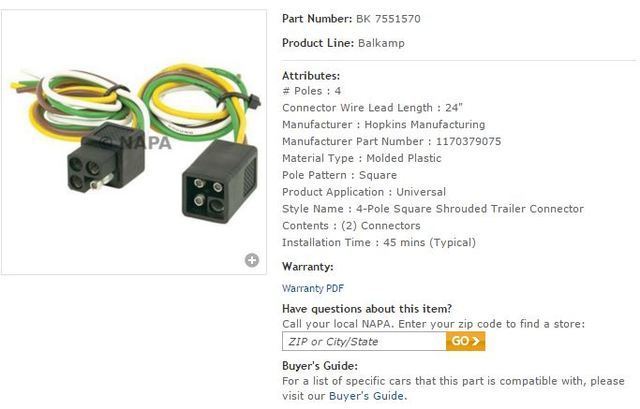

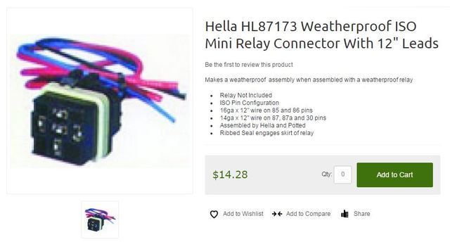

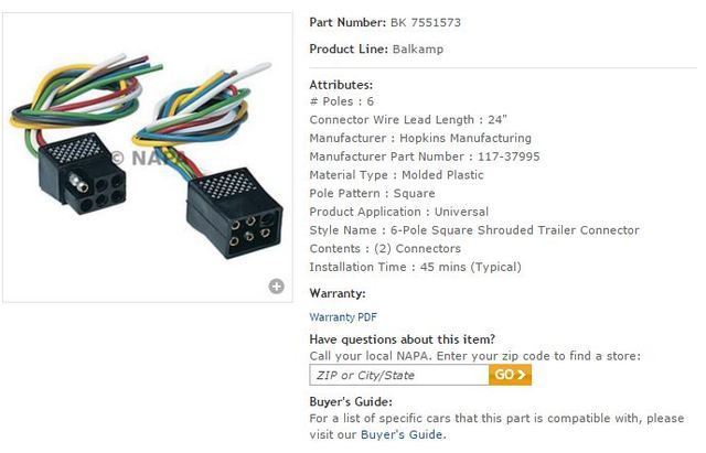

Bow_Extreme 580 #1 Posted January 13, 2016 For those of you who suffer from relay issues with your 520's and other models I believe I have a more permanent solution for you. The relays used in the 520's are Hella 960 388-07. These are somewhat of an openstyle relay at the connector side. The connector is also open and can fill with debris, short out, and degrade to a non-working condition. You should be able to order the following part numbers to replace your relays and female connectors. Hella Weatherproof Skirted Relay: HL87411 Hella Weatherproof Female Connector w/12" pigtails: HL87173 Solder in the female connector to your current wiring and replace the non weatherproof relay with the weather proof relay and your back in business. Engine Harness: Clip the old harness connectors from your wiring harness. Go to Napa and buy yourself a 4 pin square trailer connector and a 6-Pin(You can get a 5 Pin) rectangular trailer connector for a total of $9-10. Solder in the connector wiring pigtails, shrink wrap, pack the connector full of dielectric grease and your ready to roll again. They are far better than the 9-Pin connector you can purchase as they are sealed connectors when your done. These items take a little time to solder in or you could use crimp connectors(recommend the shrink style connectors if your going to use them) and be in business in a little shorter time. This should help those of you who are using your tractors in this winter weather and help keep your electronics high and dry and your tractor running strong!! I also posted on another topic a while back regarding the fuse block issues. You can simply purchase sealed inline fuses and solder these into your current wiring, throw in the 15,25, & 30 amp fuses, throw away the open fuse block, and never worry about fuse issues again. Pics Attached for reference. 10 Share this post Link to post Share on other sites

Bow_Extreme 580 #4 Posted January 13, 2016 12 hours ago, cheesegrader said: I've already replaced the fuse block on most of my tractors. The 9-pin connector and relays are the remaining weak links. I am going to add these projects to my spring tune-up list. I never heard of weatherproof relays. Learn something new every day. Where did you find them? Thanks for the information. You can find the relays in many places online. I order mine from Susquehanna MotorSports (www.rallylights.com) But you can cross reference to many other types such as Bosh & Tyco. You can also buy from Napa or other Automotive parts stores as these relays are used in many applications of similar nature. All depends on cost at each location. Share this post Link to post Share on other sites
