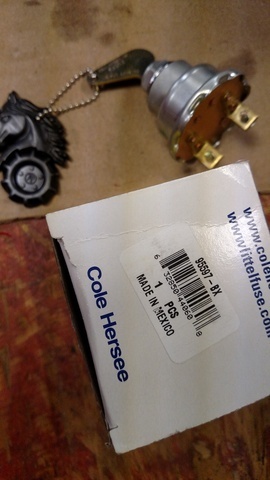

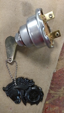

RedRanger 1,470 #5 Posted January 8, 2016 (edited) I just bought all new ignition parts to build my 852. I purchased a Cole-Hersee 2 post on/off switch on-line for about $18. Part number 95597. 50amp fits and looks like original. Even has the Hencol key. Page 33 of the catalog. http://www.colehersee.com/home/catalogs/ file:///C:/Users/Gateway%20admin/Downloads/1303152454-CLH-080MasterCatSectionC.pdf Edited January 8, 2016 by RedRanger 1 Share this post Link to post Share on other sites
whtractors24 3,453 #6 Posted January 8, 2016 1 hour ago, RedRanger said: I just bought all new ignition parts to build my 852. I purchased a Cole-Hersee 2 post on/off switch on-line for about $18. Part number 95597. 50amp fits and looks like original. Even has the Hencol key. Page 33 of the catalog. http://www.colehersee.com/home/catalogs/ file:///C:/Users/Gateway%20admin/Downloads/1303152454-CLH-080MasterCatSectionC.pdf Thank you I signed up on there site says they will send me a quote ? What's that about . Share this post Link to post Share on other sites

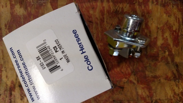

RedRanger 1,470 #7 Posted January 8, 2016 1 hour ago, whtractors24 said: Thank you I signed up on there site says they will send me a quote ? What's that about . Don't know. I did a google search and found an on-line vendor that sold the parts. I bought the keyed switch and push button starter from here.... http://www.partdeal.com/cole-hersee-sw-ign-2pos-95597-bx.html?zmam=74973193&zmas=1&zmac=4&zmap=77166450&gclid=CI2g7rivmcoCFdgcgQodxcYIow You may also want to search Ebay for the part numbers Cole Hersee 95597 and 9183. I saw a few of the keyed switches on Ebay for a better price, but I needed both and with shipping, I was better off getting them both from the same seller. 1 Share this post Link to post Share on other sites
