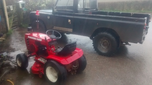

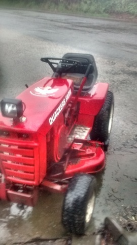

devonionredneck 17 #1 Posted January 1, 2016 Just picked this this up over the new year, think its a c120 needs some tlc, ( new bearing in PTO, wheel has has slid on axle, needs a new battery,) but seems solid, the decks going up for sale if anyone needs one, I bought it as a parts tractor but its too good to break, so its gonna be the main mowing tractor now, so I can have a dedicated Rotavator tractor, 8 Share this post Link to post Share on other sites
DennisThornton 4,773 #2 Posted January 1, 2016 Nice find and a keeper for sure! You are having a Happy New Year! Share this post Link to post Share on other sites
DougC 2,643 #3 Posted January 1, 2016 Very interesting tractor. Looks well taken care of. Share this post Link to post Share on other sites

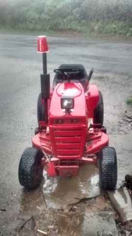

devonionredneck 17 #4 Posted January 1, 2016 Started working on it this afternoon, the stack exhaust the p.o's installed has allowed rain water down into the engine, so some clean up needed there, on the plus side it's not seized, Share this post Link to post Share on other sites
Anglo Traction 761 #5 Posted January 1, 2016 Look's a good sound machine. If it is a C-120 as you say, I can help with PTO bearings and seal, send me a PM if you need any help. Share this post Link to post Share on other sites
953 nut 64,215 #6 Posted January 1, 2016 Quackers Farm, must have belonged to a duck farmer. I think a little Marvel Mystery Oil through the exhaust could help out with the water problem, hope that works out OK. 1 Share this post Link to post Share on other sites
devonionredneck 17 #7 Posted January 1, 2016 The p.o did indeed have ducks, and some bigger tractors, seemed a nice bloke, he said he hasn't ran it in a year since the PTO crumbled, so that explains the water ingress, I think it'll clear if I spin it over with the spark plug out, doesn't seem too bad. Waiting for the weather to brighten up so I can work on it, as my workshop is being sqautted in by goats at the moment! Worse case scenario its gonna donate some bits to my other c120, though I'm not convinced this is a c120 tbh, there's a few differences and the p.o thought it was a raider 12 , so it will remain a mystery till I read the seriel number I guess 1 Share this post Link to post Share on other sites
devonionredneck 17 #8 Posted January 3, 2016 well its up and running, cleaned up and re-gapped the points, drained a lot of water out the sump and cylinder head. fresh oil, clean petrol and a set of jump leads off the landy and off she went! engine runs smooth and clean considering it was parked up for a year outside. so very very pleased with it considering what I payed for it, just the pto to deal with when i get chance! 1 Share this post Link to post Share on other sites
Horse46 519 #9 Posted January 4, 2016 Looks like a Raider to me, I have a 101 and 161 and they both have the regulator on the bulkhead, and a different style steering wheel. Are you going to run the lights? I'm looking for the back part of the front lights for one of mine if you are interested in selling that bit? Share this post Link to post Share on other sites
JC 1965 1,543 #10 Posted January 4, 2016 Very nice tractor. Looks like it's been well cared for. You need to pick up a rain cap at Tractor Supply for that exhaust stack. Share this post Link to post Share on other sites
devonionredneck 17 #11 Posted January 4, 2016 rain cap, is defiantly being bought! jam jar is on it for the time being, horse 46 sorry but the light bucket was actually the primary reason i bought it, as my c120s missing hers, for what the tractor cost me i figured i could justify it, its just been a bit of a bonus that it runs, Share this post Link to post Share on other sites

meadowfield 2,953 #13 Posted January 5, 2016 Nice find, looks like a C120, don't think it's a raider as it has separate brake/clutch. need to see the pto arrangement to tell properly, though I be I can see a lever and not a handle. Share this post Link to post Share on other sites

Anglo Traction 761 #17 Posted January 5, 2016 (edited) 41 minutes ago, devonionredneck said: I've ran the model number on the Toro website and indeed meadowfield is right its a c120 (pto matches my other tractor) I never realised the raider had a combined brake clutch . Does any one know how to date the year of manufacture on the serial numbers? just out of curiosity, id like to know which of my c120s is older, the new one has a steering wheel like my norlett commander ( wheelhorse a90 special) whereas my original one has a far more solid one with two spokes and an embossed wheel horse badge in the centre , the new one also has an ammeter while the other doesnt ( though this could have been removed by a p.o) You can't date them based on serial number, but you can get an idea. Only the Model number can be used to date these Tractors assembled in Belgium. In U.S built Models, some of which were imported had a 'Julien Build Date' Number stamped on the Plate. Your Steering Wheel is British built and supplied to the Assembly Plant in Belgium, as well as many of the Seats fitted (like yours). Looking at your first C-120 pics in your initial July Thread, that Tractor is the older one I reckon. Pics in this thread of your latest are, from what I can see show it as a date of around 75 or later. They changed the style and retainers of the front Rims in 75/76 (in U.S), It appears you have the later style wheels?, unless they are retro fit by someone. Belgium used up surplus parts to build Tractors, so they don't always conform to Parts List Spec of a certain Model/Year. So what are the Model and Serial Numbers?. My Tractor numbers appear in my signature at the bottom here if you want a comparison, and yes, one is a Single Pedal (72) and the other 2 pedal (74) Edited January 5, 2016 by Anglo Traction Share this post Link to post Share on other sites

Anglo Traction 761 #20 Posted January 5, 2016 Both are 1975 -ish then !. If the front wheels are bolted retainers, then someone has replaced the front wheels for the later version. If they are retained by 'E' or 'C' Clips, then they also changed the Spindles. No issue with that, but makes it awkward to I.D. correctly. Got any numbers off the Kohler?. Share this post Link to post Share on other sites
devonionredneck 17 #21 Posted January 6, 2016 (edited) only got engine no.s on the older one, spec no. 4752290 serial no. 1723608311 thanks for the help dating them i reckon the hubs on this one must have been changed as they are the c clip type, Edited January 6, 2016 by devonionredneck Share this post Link to post Share on other sites
gwest_ca-(File Mod) 12,009 #22 Posted January 6, 2016 Somewhere in this mess is the parts list for your engine made for the Hesston Co. (Found it on page 18 but no list shows up. Will keep looking) https://www.partstree.com/parts/kohler-engines/engines-horizontal/k301-47522-kohler-k301-engine-k-series-hesston-co-12hp-9kw-specs-4710-47835/ The 1-0357 used a Tecumseh engine on the American side of the big pond. The 1723608311 Kohler serial was made in 1987 Garry Share this post Link to post Share on other sites
devonionredneck 17 #23 Posted January 6, 2016 I can only assume a replacement engine then, funny, it looks original and until now I had no reason to believe otherwise Share this post Link to post Share on other sites
