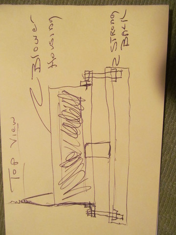

Ed Kennell 43,920 #7 Posted December 30, 2015 I have never had to straighten an auger, but I have straightened truck bumpers and snow plow blades using a wood 4 x 4 as a strong back and pulling the bent part back into shape with threaded rod. If I had a bent auger, I would try to straighten it in the blower housing. Use the 3 bolt holes on each side of the housing to attach pieces of angle iron. Using threaded rod, blocks, and strongback, pull the auger back into shape. The key will be to find the "high spot" and lock it in position so the auger doesn't spin. I don't think a steady pull will damage the bearings. Pardon my doodling. 1 Share this post Link to post Share on other sites

Ed Kennell 43,920 #9 Posted December 31, 2015 If you take it apart, you may want to put in new bearings as they will probably be damaged during removal. Option #2...buy another used blower and keep this one for spare parts. Blowers go for $150-250. I think Ericj just sold one for $70. Share this post Link to post Share on other sites
psalms83:18 174 #10 Posted December 31, 2015 I think I gonna try your strong back bolt down method on a steel bench table I have..but I'm gonna try with the auger out first...thanks guys ill keep updated 1 Share this post Link to post Share on other sites
DennisThornton 4,772 #11 Posted December 31, 2015 16 hours ago, ekennell said: I have never had to straighten an auger, but I have straightened truck bumpers and snow plow blades using a wood 4 x 4 as a strong back and pulling the bent part back into shape with threaded rod. If I had a bent auger, I would try to straighten it in the blower housing. Use the 3 bolt holes on each side of the housing to attach pieces of angle iron. Using threaded rod, blocks, and strongback, pull the auger back into shape. The key will be to find the "high spot" and lock it in position so the auger doesn't spin. I don't think a steady pull will damage the bearings. Pardon my doodling. Well I like that idea of using threaded rod! Sometimes the simplest of things gets the job done! I recommend a very controlled force and expect to over straighten a bit so it can spring back a bit to true straight. 1 Share this post Link to post Share on other sites
Ed Kennell 43,920 #12 Posted December 31, 2015 7 minutes ago, DennisThornton said: I recommend a very controlled force and expect to over straighten a bit so it can spring back a bit to true straight. And that spring back means trial and error to get it straight. May need to spin it in Vee blocks to check straightness after each attempt. Share this post Link to post Share on other sites

DennisThornton 4,772 #14 Posted December 31, 2015 1 minute ago, ekennell said: And that spring back means trial and error to get it straight. May need to spin it in Vee blocks to check straightness after each attempt. Trial and error, absolutely! Perhaps over-straightening a time or two! But as long as force can be applied where needed I believe doable. Fins will no doubt get in the way and I could see that being a PITA! Share this post Link to post Share on other sites

Ed Kennell 43,920 #20 Posted January 6, 2016 (edited) Looks like the nylon straps are the limiting factor in your set up. I like the rigidity of the steel table and jack stand, and I would pull the auger down with threaded rod. A 4x4 timber or 3x3x1/4 angle iron above the auger and below the table and 4 pcs of 1/2-13 threaded rods with greased double flat washers under each nut will pull 6-8 ton. Edited January 6, 2016 by ekennell 2 Share this post Link to post Share on other sites
