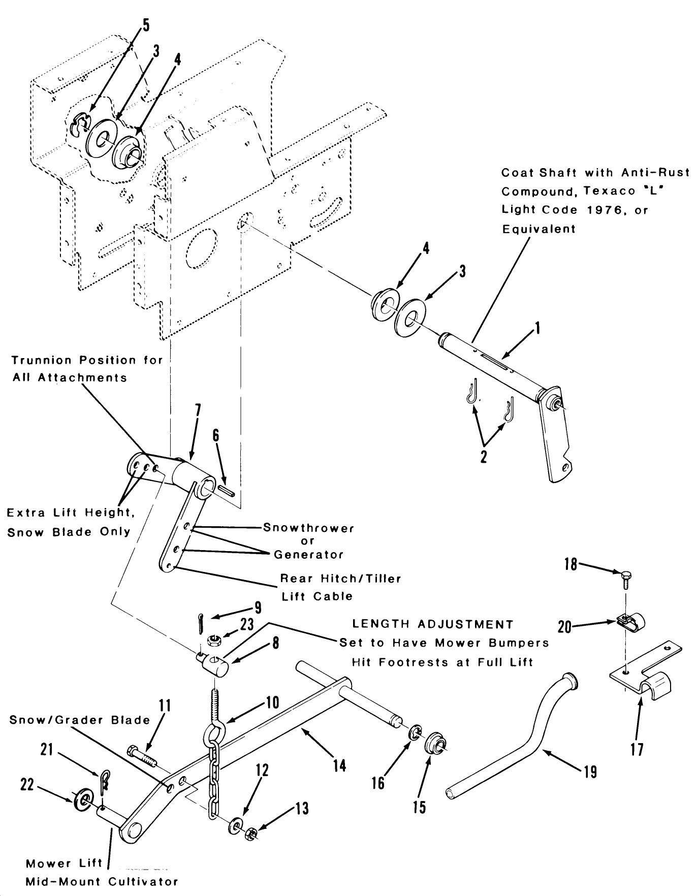

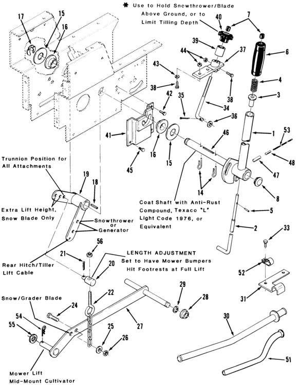

daveoman1966 3,858 #3 Posted December 29, 2015 Here are pics of the 418-a HYD lift and the MANUAL You could use a die grinder and cut-off wheel to split the tube of the rockshaft (# 7 or #19) to release pressure, then drive it out. Having done that, I can provide a replacement rockshaft. for further details, send direct email to me at this address: (just clik the link) daveoman@windstream.net 1 Share this post Link to post Share on other sites
cod 121 #4 Posted December 30, 2015 Ed, Thanks to Dave's pictures, you can see there are hair pin clips that help keep the rock shaft in place. They came out just like they should and I hoped that the shaft #1 (first diagram) would just slide out with some heat and a couple of whacks with a hammer. WRONG!!! The little propane torch I have just doesn't cut it and I have to find it's big brother. Dave, Thanks for the picture and if I end up destroying the rock shaft, I'll be in touch. I was really hoping that the hood support ( the dashed outline in the upper left ) would come apart but I suspect they spot welded it for strength. Cod 1 Share this post Link to post Share on other sites

doc724 925 #8 Posted December 30, 2015 Dennis and Hank have the right approach. Use patience. If PD blaster does not work, buy some Kroil-it is 4X the price but works better. I have had to pull the rock shaft out of two late 70's model tractors. You cannot swing a hammer in there, however if you pull on the lift lever (make sure you have removed item 5 and 41 in Daveoman's pix), the rock shaft will hit the side of the tower and should slide off. 4 Share this post Link to post Share on other sites
