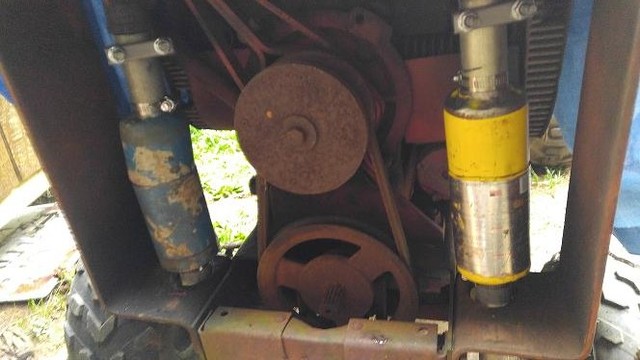

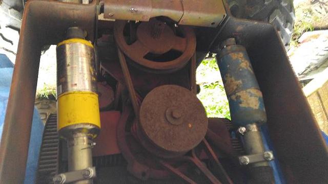

Mike_Eddleman 70 #1 Posted December 28, 2015 I have been looking for mufflers for my D180 and just couldn't find anything I could afford right now so this is what I came up with and for now it works good, It cut the sound by 2/3rds. I took 1 1/4 emt and cut slots in it 14 of them in 4 rows over a 8 inch span and then took a punch and bent the bottoms of the slots in so that they catch the exhaust then I wrapped the emt with 1/2" square wire mesh and then wrapped the mesh with fiberglass about 3/8 inch thick and then wrapped that with wire just to hold it all in place. I took empty torch cylinders and drilled 1 1/4 holes in each end and then cut them in half and covered the fiberglass. I installed them just to see if they worked. Now I will take them off and welt them up and reinstall them. Like I said they might not work for long but they sound great for now not sure what is going on with the picture 9 Share this post Link to post Share on other sites

953 nut 60,629 #3 Posted December 28, 2015 Home brewed Glass Packs, love it! 4 Share this post Link to post Share on other sites
DennisThornton 4,771 #4 Posted December 29, 2015 I've considered the same thing and you and I are not the first! I've heard the fiberglass doesn't last forever but there's more than one way to skin a cat! Stainless "Chore Boy"s, stainless baffles and... Let us know how they hold up, please! 1 Share this post Link to post Share on other sites
