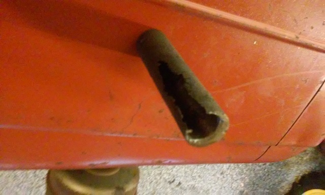

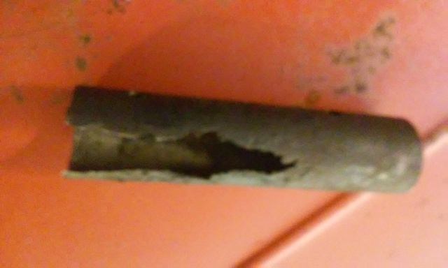

MalMac 1,334 #1 Posted December 28, 2015 Been trying to get a froze hitch pin out (like we have never heard that one before have we gang lol.) finally got the pin to rotate in the transmission. The crazy thing is froze in the slot hitch. So the first battle of the war was won. Now just cut the pin between the case and the hitch and the war should swing in my favor. There should be some kind of a medal for all of the guys and gals that have fought this war and won and survived. Drilling, air chiseling, sawing, etc. takes a toll on the ol arms. Not to mention the desire to just say _ _ _ _ it , and just walk away. But we all keep at it till the war is won. This particular one has been a tuffy so far and looks like it will fight to the bitter end. 9 Share this post Link to post Share on other sites

MalMac 1,334 #10 Posted December 30, 2015 The shop is quite now. No more sounds of a BFH, the sounds of a saws-all or noise of a air chisel. Gone are the few choice well used swear words. The battlefield is silent, the battle over the war won. I stand here triumphant with my surrendered enemy, the frozen hitch pin in hand. This is just not a lone victory but a victory for all Red Square members that have faced this battle and for all who will face it again, and for all who will face it for the first time. That there is hope in determination to face down this dreaded enemy that stands in are way of the perfect transmission rebuild. Talk about laying on the BS. Lol, Anyway it's out! Time to celebrate. 4 Share this post Link to post Share on other sites

MalMac 1,334 #12 Posted December 30, 2015 Denny I have done a bunch of these, but this one was the worst. I'll be honest I was starting to think it just might not happen. A lot of blaster and patience and a few choice words. I might have to go apologize to the neighbors down the road. I am sure they heard me. 1 Share this post Link to post Share on other sites

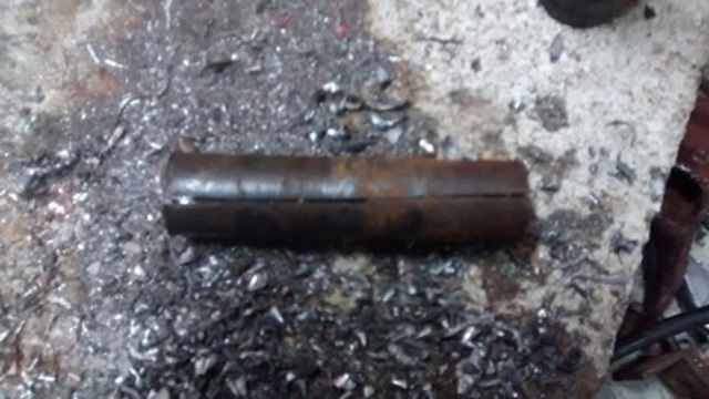

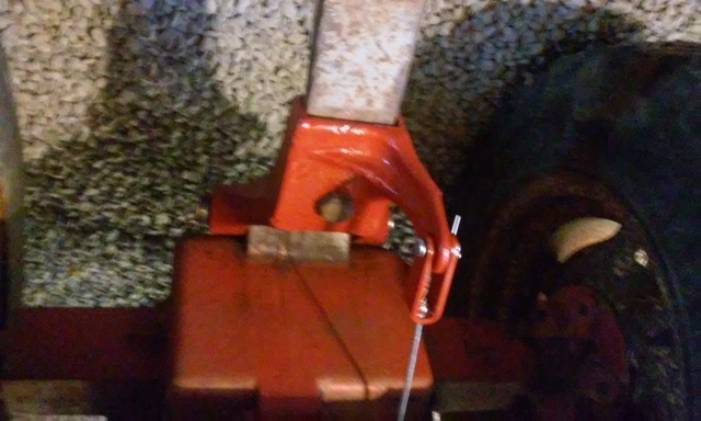

rjg854 12,864 #17 Posted January 1, 2016 (edited) On 12/28/2015 at 5:22 AM, Ranger13148 said: I just got the pin out of the transmission on the 854 I just bought, a battle indeed, but I won, and as luck would have it, I didn't break anything else in the process, SWEET! Someone had cut the pin off on both ends and left the rest of it stuck there in the transmission. I had drilled some holes in the mounting area and kept soaking it with PBblaster for quite some time before I started to try to get the pin out. With a 1/4" bit I drilled 80% of the way thru the pin, and then used a 1/2" bit and chased the first hole with that. I kept the hole close to the cast of the transmission to relieve the stress of the pin all the way around. A couple of days of beating on it, heating it, soaking over and over, I managed to win the battle. I just got a pin and lift cable from wheelhorseman, and a slot hitch from Jake Kuhn, thanks guys, and very soon the 854 should be able to pull something again. So this is what the pin looked like after I finally was able to get it out, and then the result of a new slot hitch, pin, and a lift cable. A big thanks to Jake Kuhn for the slot hitch and Wheelhorseman for the pin and cable Double picture Don't know why the pictures are upside down and can't see how to rotate them Edited January 1, 2016 by Ranger13148 Share this post Link to post Share on other sites
