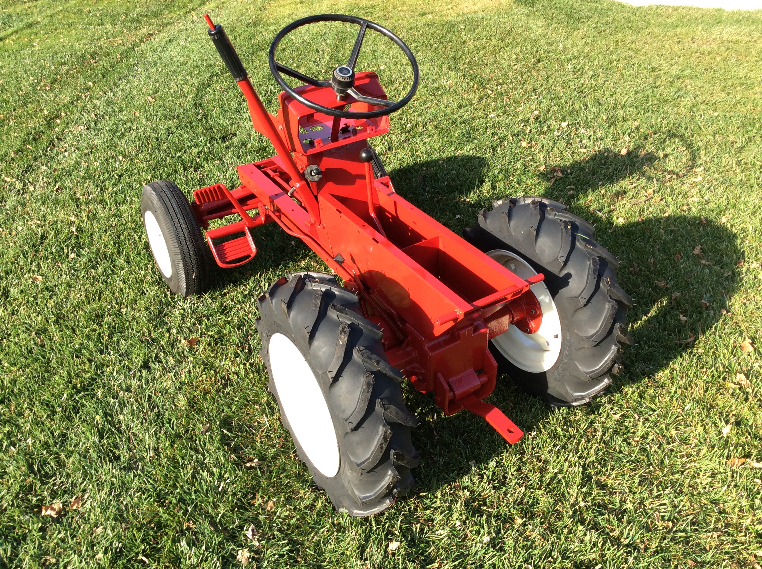

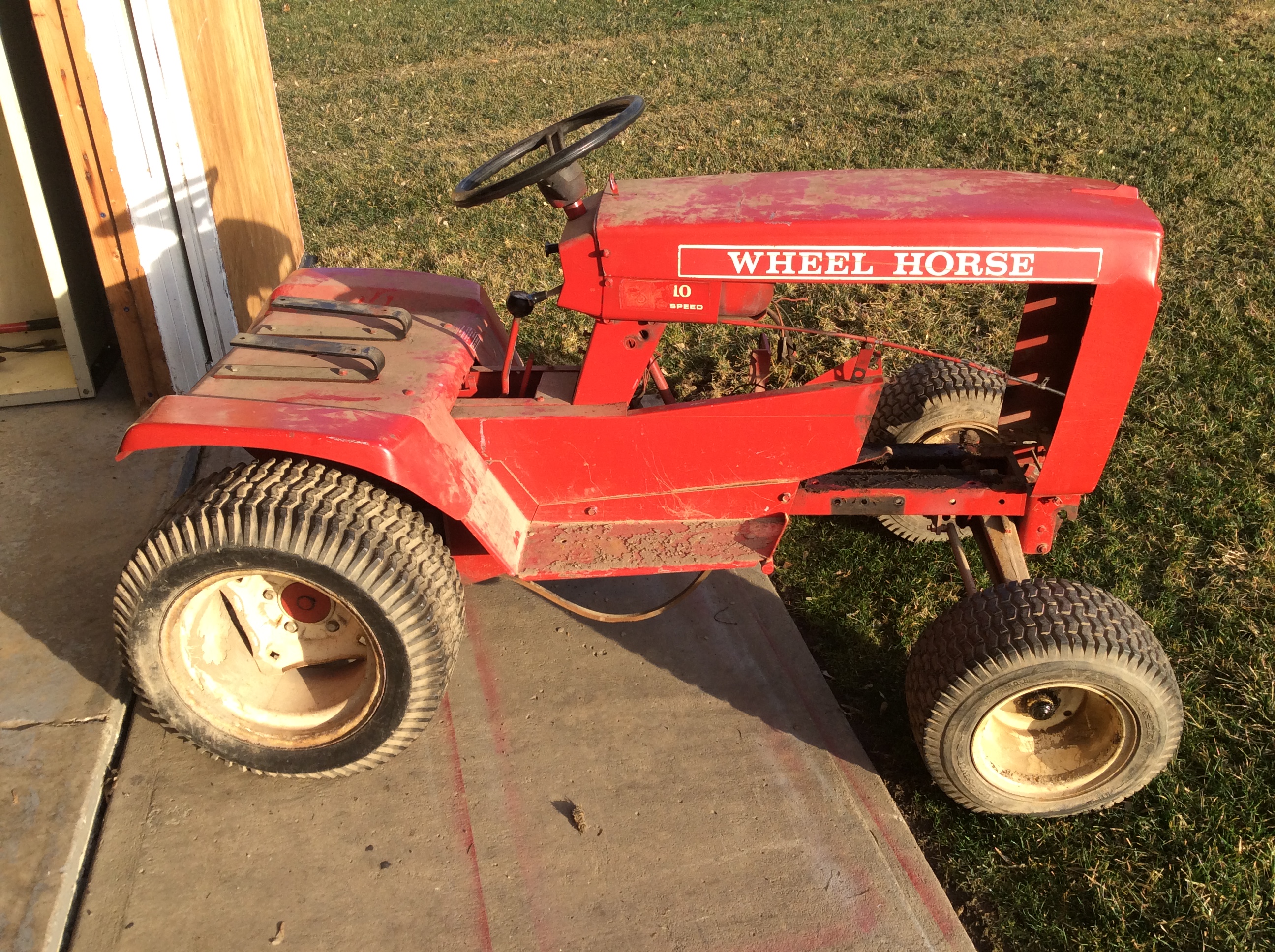

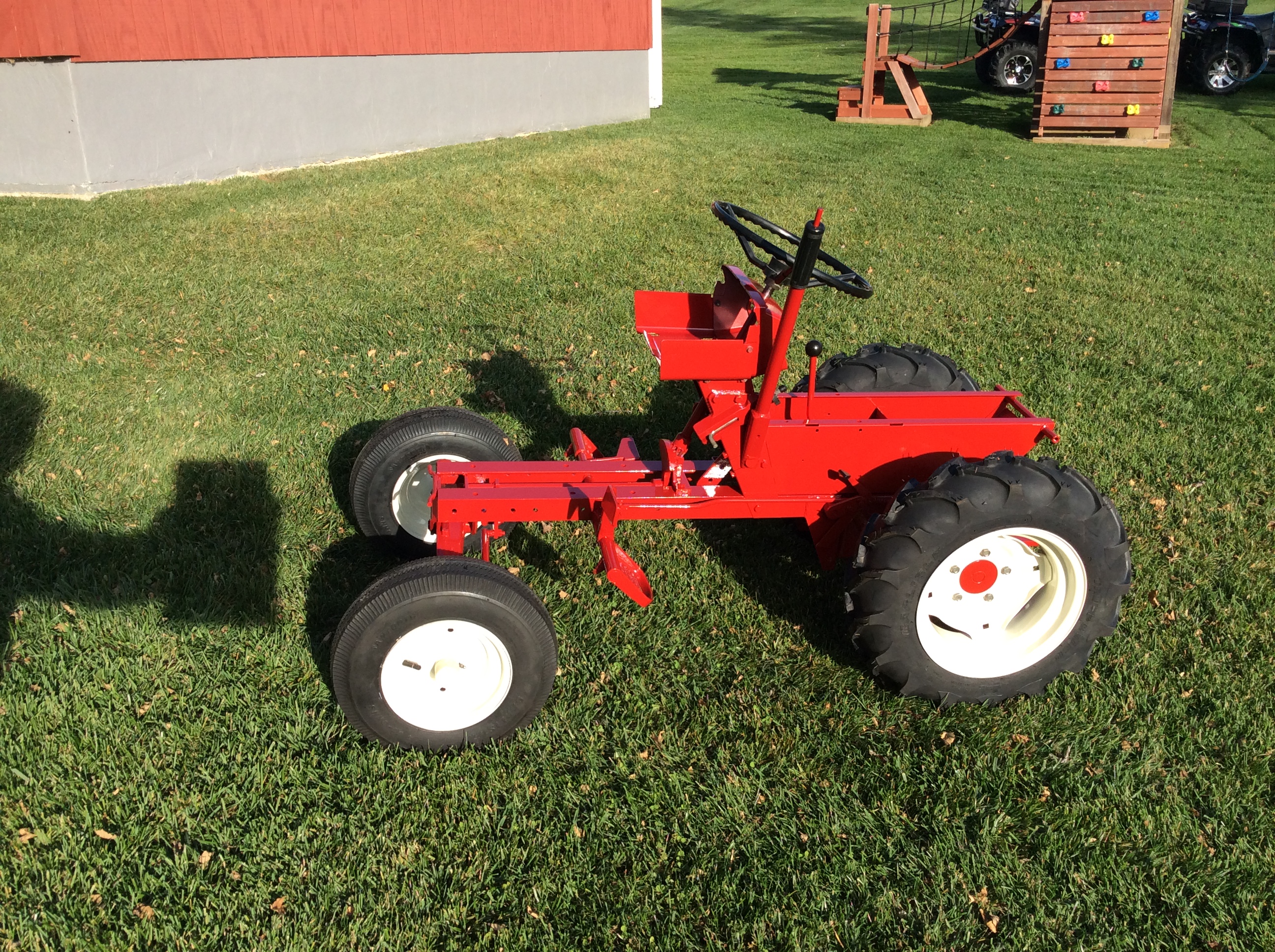

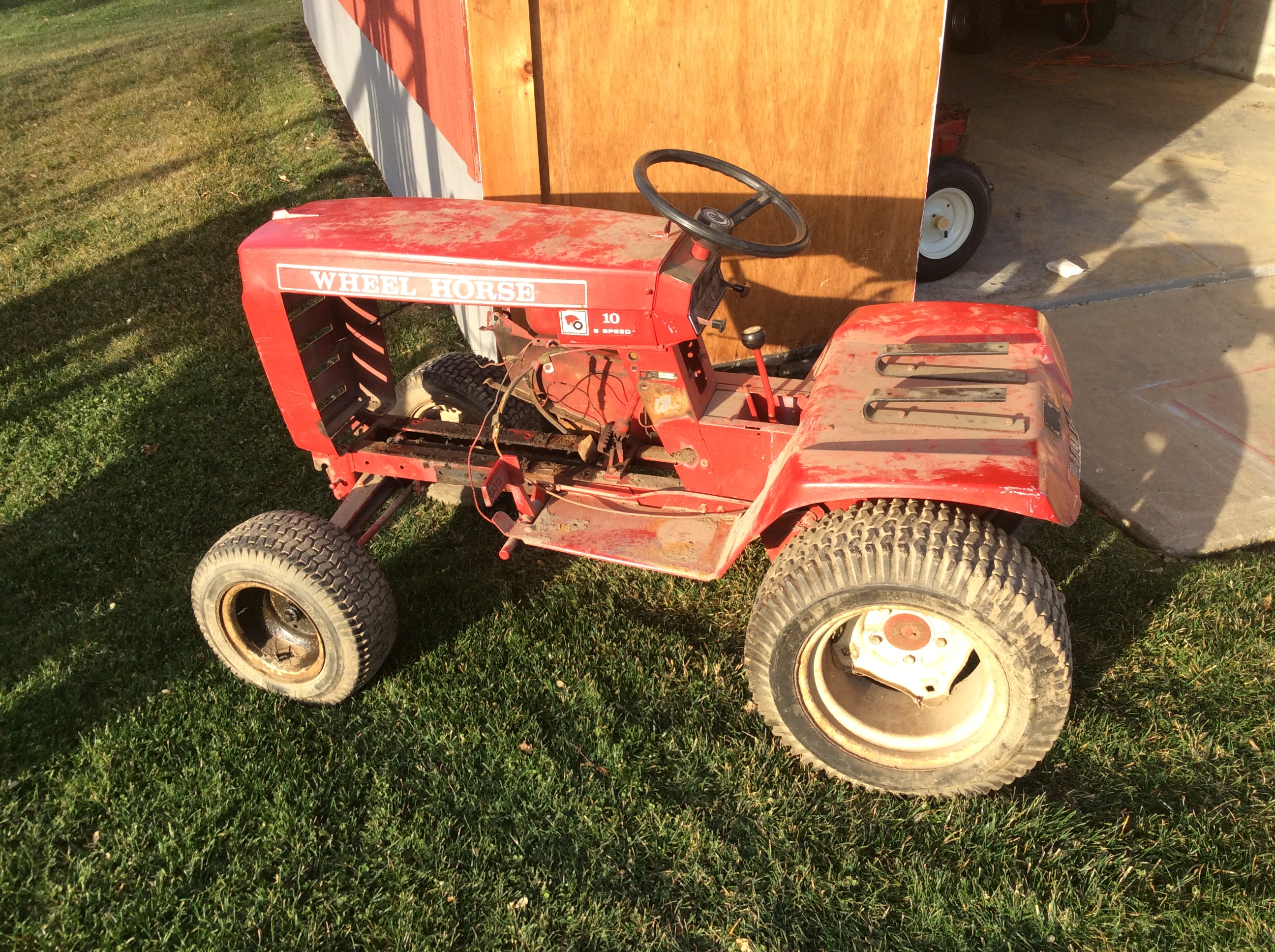

emwrench 1 #7 Posted December 28, 2015 Here are a couple of pictures of the new project tractor for my son, a couple of the in progress pictures and a before shot of my Dad's 1969 Workhorse 700. That was the first motorized vehicle I ever drove. I want to rebuild/modify the 1973 so my son can have the same experience with his own tractor to drive/learn/care for. 1 Share this post Link to post Share on other sites
