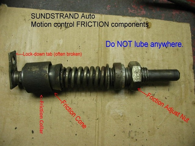

daveoman1966 3,882 #3 Posted December 28, 2015 (edited) Here is a pic of the entire friction assy. I have these parts....For further details, send a DIRECT EMAIL to me at this address (just clik the link) daveoman@windstream.net Edited December 28, 2015 by daveoman1966 1 Share this post Link to post Share on other sites

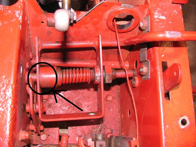

keefer66 14 #4 Posted December 29, 2015 (edited) 20 hours ago, daveoman1966 said: 23 hours ago, keefer66 said: not really looking for parts , but was curious if anyone else had this problem and how they solved it. ( i believe the lever frame is worn enough to create slop in the lever Edited December 29, 2015 by keefer66 Share this post Link to post Share on other sites
jeremi3210 743 #5 Posted January 1, 2016 I've seen this. Take it out of the tractor and tap on that spot with a hammer. It's kinda crude but it works. Share this post Link to post Share on other sites
