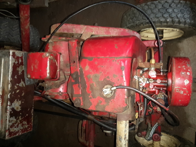

carlosking450 161 #1 Posted December 27, 2015 Hello good morning yesterday I was inspecting my wheel horse 702 and did not see any identification engine you can tell me what kind of motor is to buy parts and check the manual? Share this post Link to post Share on other sites

carlosking450 161 #4 Posted December 27, 2015 That board does not have my engine there is any identification number or recorded on the block? Share this post Link to post Share on other sites

carlosking450 161 #6 Posted December 27, 2015 I have to do the photos but it takes a while since I have the tractor where I live thanks 2 Share this post Link to post Share on other sites

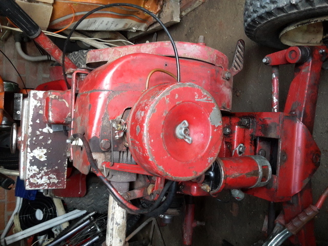

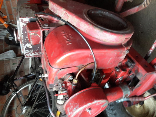

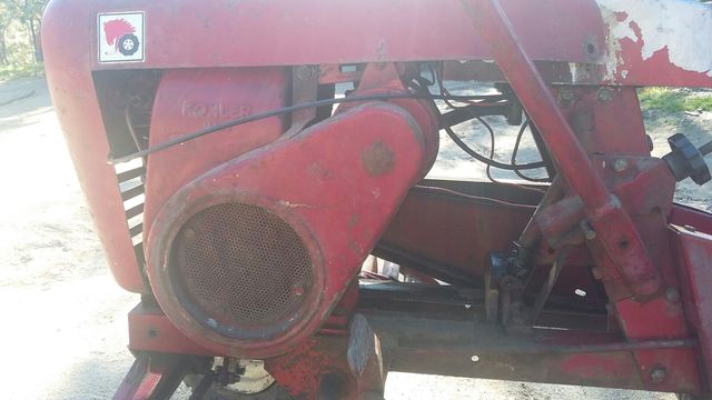

carlosking450 161 #7 Posted December 28, 2015 good night friends have searched and found these pictures if used to identify the engine model thanks 3 Share this post Link to post Share on other sites
953 nut 63,105 #8 Posted December 28, 2015 Hard to say what parts are original and what has been altered over the past 53 or 54 years. One thing I can say for cretin, you have a very nice 70? there. 1 Share this post Link to post Share on other sites

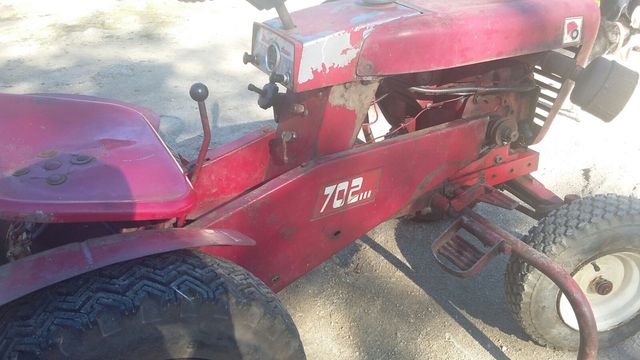

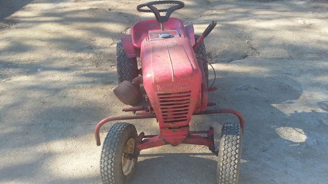

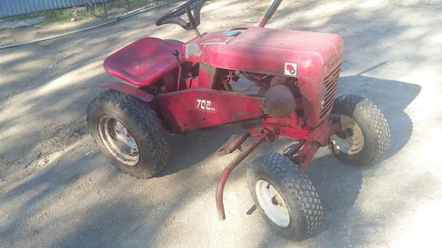

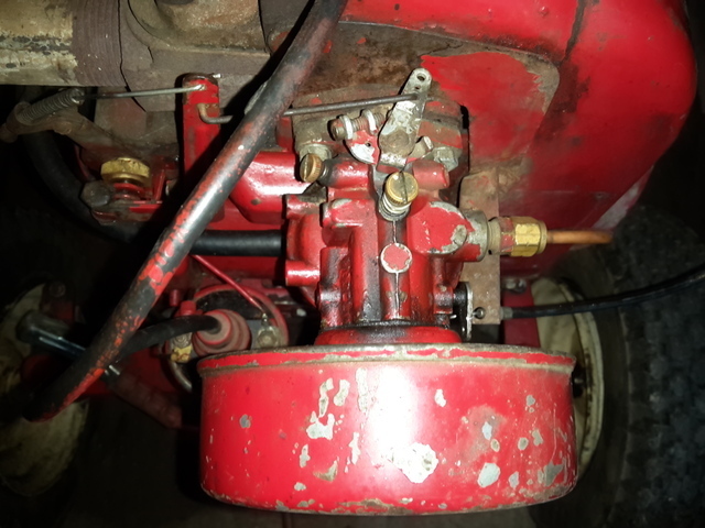

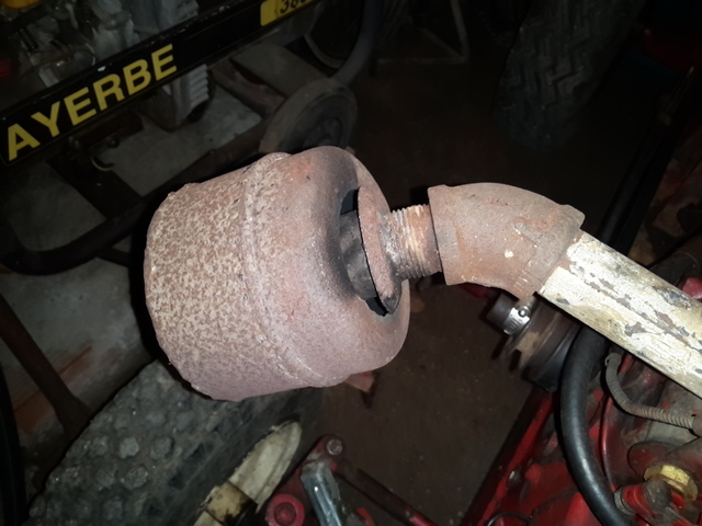

carlosking450 161 #9 Posted January 10, 2016 Here you have the photos of my Wheel Horse 702 you know tell me that motor model is only having 7hp thanks 1 Share this post Link to post Share on other sites

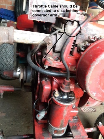

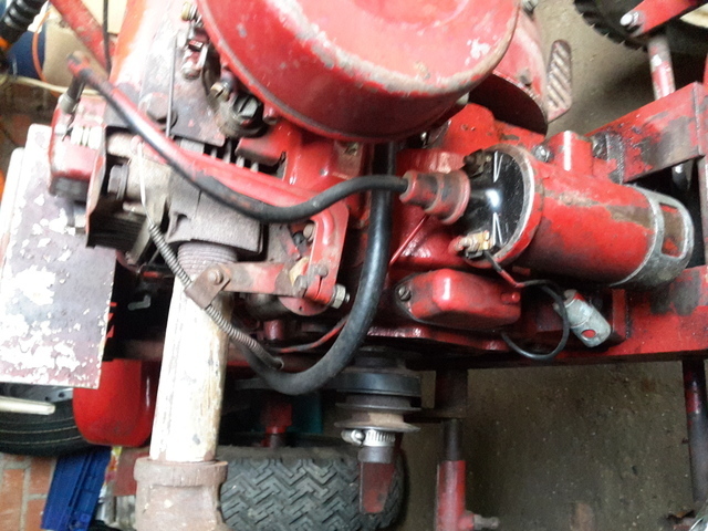

buckrancher 2,695 #10 Posted January 10, 2016 better change the throttle hook up if you don't want to blow up the engine tractor also has a 1963 frame and front axle so it may be a 753 with 702 parts on her steering wheel is incorrect and choke cable is routed wrong over all nice tractor older round noses are getting harder to find in good shape Brian Share this post Link to post Share on other sites
wallfish 18,791 #11 Posted January 10, 2016 Yes, engine is a Kohler K161 and 7hp 1 Share this post Link to post Share on other sites
squonk 44,901 #12 Posted January 10, 2016 Not only that. I see kinks in that throttle cable. Hate to see it get stuck and the engine go BOOM!!!! Share this post Link to post Share on other sites
AMC RULES 37,250 #13 Posted January 10, 2016 What's holding that engine pulley on? Share this post Link to post Share on other sites

carlosking450 161 #16 Posted January 10, 2016 Hello good friends have to put the throttle cables and choke and motor pulley has a clamping sleeve it is not whether you can get the polea.Voy need much help I ask your patience with my language So it puts a 702 but I do not have parts that are not theirs because the few models on Spain to change them pieces Could get pictures as they guided the throttle cable and choke ? I would greatly appreciate it Share this post Link to post Share on other sites

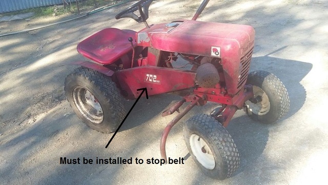

carlosking450 161 #17 Posted January 10, 2016 Another problem I have is that these speeds get scratched by him do not stop pulley change , I think the belt is too short and never loosens the suficinte.En your wheel horse to get to full speed pulley clutch change when stepping right? Share this post Link to post Share on other sites
wallfish 18,791 #18 Posted January 10, 2016 Install the belt guard cover. The cover will support the belt and stop it from turning 1 Share this post Link to post Share on other sites
AMC RULES 37,250 #19 Posted January 10, 2016 You can only shift it when it's completely stopped Carlos. Share this post Link to post Share on other sites
carlosking450 161 #20 Posted January 10, 2016 Cover with lid or without the belt loosens like the cover does not have any mechanism figured I should stop completely pulley you want to thank your fast answers 1 Share this post Link to post Share on other sites
