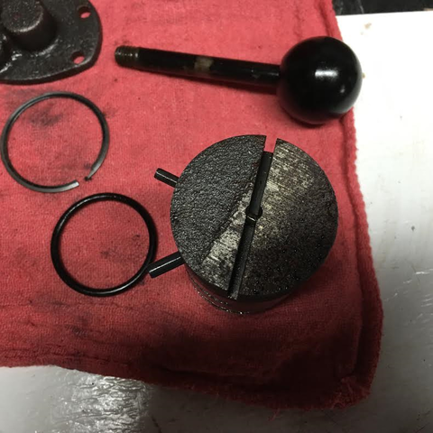

whtractors24 3,454 #16 Posted December 30, 2015 Ok so I got it all apart there is no pieces nor any spring at all hmm .... Well ill I got the spring and all the parts on the way my question is the roll pin that goes through the center does the n spring go under that then press the roll pin back through to hold it in place ? 1 Share this post Link to post Share on other sites

whtractors24 3,454 #18 Posted December 30, 2015 well I grew confidence spoke with indy wh a.k.a (mitchell) last night on the phone he walked me right through it seems to be a cake walk well see once I get parts if it leaks 2 Share this post Link to post Share on other sites
stevasaurus 23,627 #19 Posted December 30, 2015 If someone has not told you yet...the answer to your roll pin question is "yes"...the spring goes under the roll pin and then the pin goes back in place. 3 Share this post Link to post Share on other sites
whtractors24 3,454 #20 Posted January 4, 2016 (edited) you guys have been a big help thank you! so far I have it torn it down realized the spring is no longer is there I have all the parts on the way and should be back together in no time ! I hope no leaks ! is 32oz of hydraulic fluid from dead empty sound correct >? the new shaft seal is in! Edited January 4, 2016 by whtractors24 1 Share this post Link to post Share on other sites
