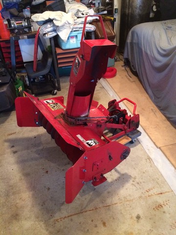

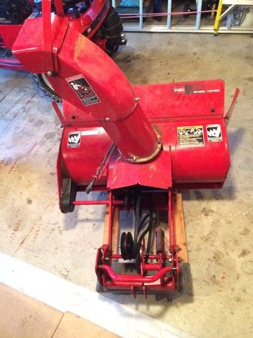

SgtBob 27 #5 Posted December 23, 2015 Previous responses are correct. xi attachments are not interchangeable. I have attached a couple photos of an xi single stage blower. 3 Share this post Link to post Share on other sites
JERSEYHAWG / Glenn 4,498 #6 Posted December 23, 2015 17 minutes ago, SgtBob said: Previous responses are correct. xi attachments are not interchangeable. I have attached a couple photos of an xi single stage blower. Bob,,, Were you sneekin around in my garage? Lol Glenn Share this post Link to post Share on other sites
WNYPCRepair 1,923 #7 Posted December 23, 2015 That looks a lot simpler than the two stage. The two stage looks like part of a train or something. 2 Share this post Link to post Share on other sites
JERSEYHAWG / Glenn 4,498 #8 Posted December 23, 2015 39 minutes ago, WNYPCRepair said: That looks a lot simpler than the two stage. The two stage looks like part of a train or something. It is. the 2 stage has MANY more parts. including its way bigger and heavier. but the 2 stage will eat up the heavier snows to. give and take I guess. Glenn 2 Share this post Link to post Share on other sites
