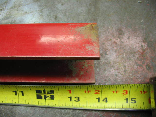

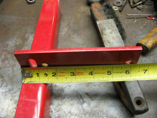

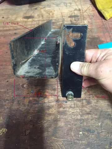

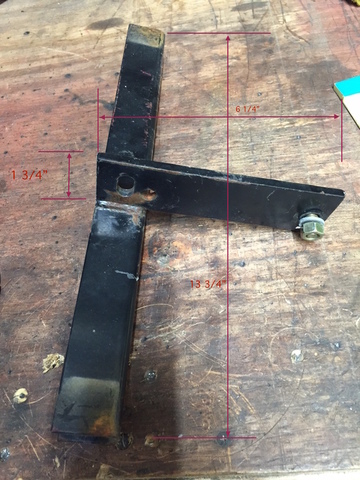

KohlerJohn 2 #1 Posted December 6, 2015 I am mounting a snow blade on a late model 520 Wheelhorse with hte gear reduction steering and need help fabricating the mid-mount adapter for the frame. I have the rear extension but unfortunately do not have the mid-mount adapter. Any help with the dimensions would be greatly appreciated. I have seen a picture of the adapter but dimensions on the piece would greatly reduce my trial and error efforts. Thanks much, John Share this post Link to post Share on other sites

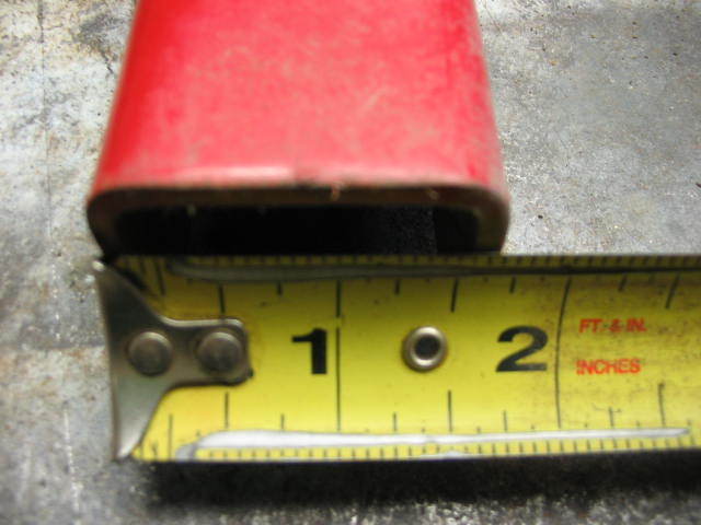

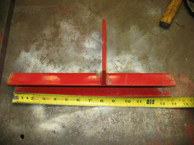

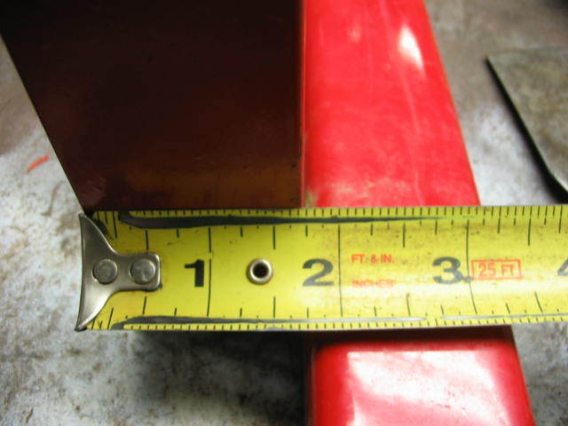

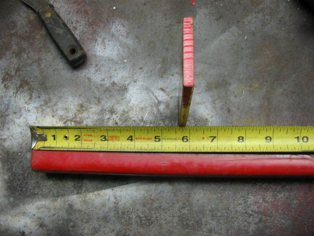

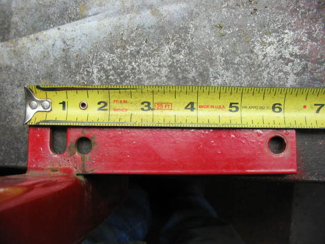

daveoman1966 3,881 #2 Posted December 6, 2015 Does this do it? ? ? ? 1 Share this post Link to post Share on other sites
KohlerJohn 2 #4 Posted December 7, 2015 Many thanks to daveomann66 and WNYPCRepair for the dimensions. It showed just what I needed! It is great to have the resources right at hand! Thanks again fellows , the problem is solved. John Share this post Link to post Share on other sites

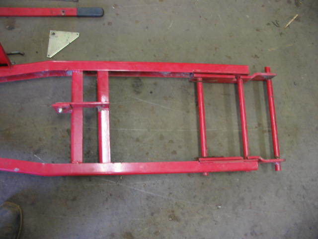

oe espo 32 #5 Posted December 19, 2015 How does this part attach to the "A" frame? Does it just tap into place and wedge in there? I don't see any bolt holes. Looks like ill have to make one also. Share this post Link to post Share on other sites
daveoman1966 3,881 #6 Posted December 19, 2015 It doesn't really bolt to the A-Frame like you would expect. It only bolts to the 'upright' bracket.... look closerly at this pic...you'll see the 3/8 bolt holding it in place. It wedges behind the original cross bar....effectively setting everything back about 4" or so. Share this post Link to post Share on other sites
oe espo 32 #7 Posted December 19, 2015 So I was thinking that bolted flat bar was part of the lift, but actually bolts to the original lift point to hold position it looks like. Thanks!!! Share this post Link to post Share on other sites
