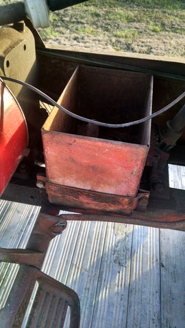

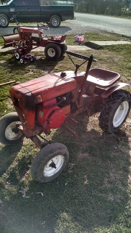

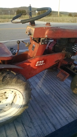

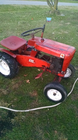

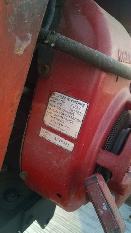

slammer302 2,156 #1 Posted December 5, 2015 Me and my son were bored today so we went and picked up this 633??? Has a Kohler motor and tool box in the battery tray its ruff but pretty cool 12 Share this post Link to post Share on other sites
AlwaysLookin80 1,308 #2 Posted December 5, 2015 Nice tractor. I lost out on one of those . Pretty rare. Share this post Link to post Share on other sites
AMC RULES 37,220 #3 Posted December 5, 2015 Cool ol' there... been on the look out for one of them myself. Share this post Link to post Share on other sites

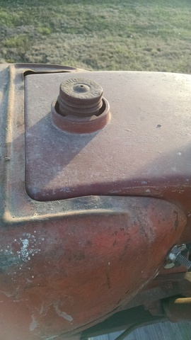

slammer302 2,156 #4 Posted December 5, 2015 the gastank looks like it has the little tank inside. I believe this was offered buy the dealer to combat the leaky two piece gastanks i've read about them but never seen one in person 9 Share this post Link to post Share on other sites

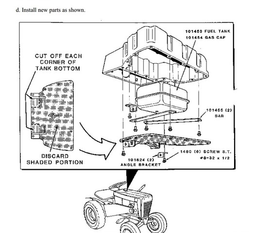

Racinbob 12,013 #9 Posted December 6, 2015 (edited) 15 hours ago, slammer302 said: the gastank looks like it has the little tank inside. I believe this was offered buy the dealer to combat the leaky two piece gastanks i've read about them but never seen one in person Right on Slammer. It was service bulletin #348 issued about 20 years after the tractors were made. I guess it too that long before time got to the gaskets enough that they finally reacted to it. You don't see many of those little boxes in place of the battery either but I think it was standard on the recoil start tractors that year. Very cool! Edited December 6, 2015 by Racinbob 1 Share this post Link to post Share on other sites

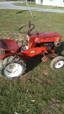

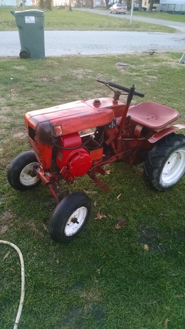

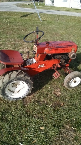

slammer302 2,156 #14 Posted December 6, 2015 Got a chance to give it a quick cleaning 5 Share this post Link to post Share on other sites
WHX?? 52,176 #15 Posted December 7, 2015 What's with the black spot on the hood, some kind of exhaust leak? Unlike me cleaned up real nice.... Be willing to bet you got a steal on it too with the plow. Rims & tires look good. Share this post Link to post Share on other sites
slammer302 2,156 #16 Posted December 7, 2015 the black spot on the hood is were sum one took torch to the hood to braze the seam up Share this post Link to post Share on other sites
WHX?? 52,176 #17 Posted December 7, 2015 YIKES......adds character I guess 1 Share this post Link to post Share on other sites
Kelly 1,033 #18 Posted December 7, 2015 Why the hood and gas tank lift kit?? Share this post Link to post Share on other sites
WHX?? 52,176 #19 Posted December 7, 2015 3 hours ago, Kelly said: Why the hood and gas tank lift kit?? Good eye Kelly.....Repower and to get it to fit??? Share this post Link to post Share on other sites
slammer302 2,156 #20 Posted December 7, 2015 (edited) 5 hours ago, Kelly said: Why the hood and gas tank lift kit?? Because the PO was to lazy to put the proper muffler on it. I do plan on fixing it back to normal but they welded the exhaust flange on so i,m going to have to get my cutting wheel out and my air compressor is broke so im going to do it the hard way Edited December 7, 2015 by slammer302 Share this post Link to post Share on other sites
bowtieguy 334 #21 Posted December 9, 2015 (edited) Barry....you didn't do enough "rubberneckin'" when you were at Larry Dexters last year....he has one of those inner tanks on the wall in his Horse Barn!! .. BTW.......Larry........where DID you find that tank?....what horse model? Edited December 9, 2015 by bowtieguy Share this post Link to post Share on other sites

mid60's 93 #25 Posted December 10, 2015 BTW.......Larry........where DID you find that tank?....what horse model? If I remember right, it was on a 753. Been a while. I almost threw it away at the time, thinking someone had stuck it in the tank and cut up the tank in the process. So never toss anything. Makes a good display though. 2 Share this post Link to post Share on other sites
