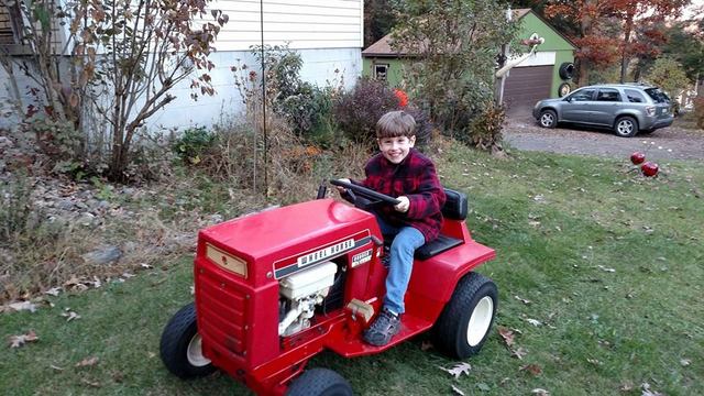

N3PUY 1,031 #2 Posted December 2, 2015 (edited) This is one type of RANGER. 1973 Ranger 800 Edited December 2, 2015 by N3PUY 2 Share this post Link to post Share on other sites
