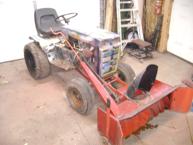

jimkemp 528 #1 Posted November 26, 2015 Well I picked up this short shoot single stage blower really cheap and got it mounted today , the tractor is UGLY but it runs and works great , last year I used a plow on it and going to try the blower this year , I will put the plow on another horse for a back up plan , I just need to put the tires with chains and I am ready 6 Share this post Link to post Share on other sites

jimkemp 528 #4 Posted November 26, 2015 Still have to figure out the lift part , its all hooked up but I can only lift it about 2" up and then it seems to bind up and wont go any further Share this post Link to post Share on other sites

pfrederi 19,804 #6 Posted November 26, 2015 Snow blowers do not lift very high. However should do better than 2 inches. Add some spacers (heavy washers or maybe a 3/4" shaft collar) between the long lift tube and the flag. Put them over the solid shaft of the flag before you insert it into the lift tube. 1 Share this post Link to post Share on other sites
squonk 45,389 #7 Posted November 26, 2015 What hole do you have the flag attached to? 1 Share this post Link to post Share on other sites
jimkemp 528 #8 Posted November 26, 2015 21 minutes ago, squonk said: What hole do you have the flag attached to? There are two holes , I have it bolted in the upper hole right now Share this post Link to post Share on other sites
squonk 45,389 #9 Posted November 26, 2015 Sounds like the right hole. You want it in the hole closest to the rock shaft itself. Share this post Link to post Share on other sites
jimkemp 528 #10 Posted November 26, 2015 12 minutes ago, squonk said: Sounds like the right hole. You want it in the hole closest to the rock shaft itself. That's the hole its in , I figured the other hole wouldn't have enough leverage Anyone know what the belt size is for this blower , its a model 66212-8 single stage , I thought there was a chart for this but all I can find is the ones for the mower decks Share this post Link to post Share on other sites
vinnyfish1 9 #11 Posted November 27, 2015 second hole on the lift arm is correct.... mine lifts about a foot with the hydro...as far as the belt goes the one I have worked well moving deep snow last year but needs replaced ....I hope to have time to take the belt I'm using to TSC this weekend and get it measured and replaced and will post the size .... Share this post Link to post Share on other sites

gwest_ca-(File Mod) 11,986 #15 Posted November 27, 2015 On 26/11/2015, 15:12:18, jimkemp said: Anyone know what the belt size is for this blower , its a model 66212-8 single stage , I thought there was a chart for this but all I can find is the ones for the mower decks 5/8" x 69" Make sure you get one designed to bend backwards over a flat idler pulley. There is no snowthrower belt chart but the tractor and mower deck charts have the belt dimenions in two different lists on the last pages of each chart. Have to use a snowthrower parts list to get the belt number. You should turn the side extensions over or trade sides. The front 2" lip should point forward. Garry 2 Share this post Link to post Share on other sites
jimkemp 528 #16 Posted November 28, 2015 18 minutes ago, gwest_ca said: 5/8" x 69" Make sure you get one designed to bend backwards over a flat idler pulley. There is no snowthrower belt chart but the tractor and mower deck charts have the belt dimenions in two different lists on the last pages of each chart. Have to use a snowthrower parts list to get the belt number. You should turn the side extensions over or trade sides. The front 2" lip should point forward. Garry Thank you for the info , the side extensions were on it when I got the blower and didn't notice them backwards until I mount it on the tractor , its been like that for a long time as I am going to have to cut the bolts or brake them with the impact gun because they are so rusted 1 Share this post Link to post Share on other sites
DougC 2,643 #17 Posted November 28, 2015 18 hours ago, jimkemp said: Thank you for the info , the side extensions were on it when I got the blower and didn't notice them backwards until I mount it on the tractor , its been like that for a long time as I am going to have to cut the bolts or brake them with the impact gun because they are so rusted When I got my used blower the extensions were not mounted on it. I put them on later and only after seeing all the blower pictures here on the forum I realized I had them on bass ackwards . Never had one before............ 2 Share this post Link to post Share on other sites
