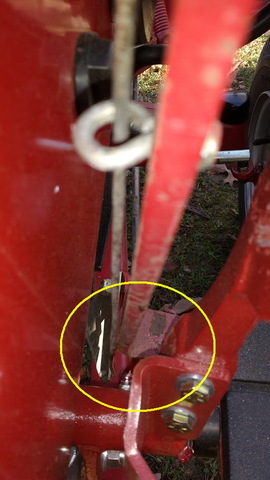

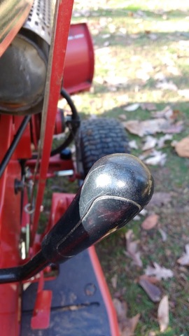

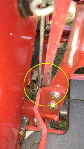

rmaynard 16,771 #1 Posted November 26, 2015 I recently installed one of Matt's foot pedal kits on my 416-H. As an alternative to the steering column mounted motion lever it is wonderful. However, I am wondering if anyone else is having a problem with the pedal conflicting with the angle lever for the snow plow. Here is my problem. I was showing my wife how to change the angle of the blade. When I pulled the lever back to angle the blade to the left, the pedal hits the lever. If I bend the lever to the left to be able to clear the lever, The top of the lever hits the muffler. Has anyone else experienced this issue, and how did you work around it? It looks like the only way to fix this is to put a z-bend in the lever. to move the bottom closer to the frame and away from the pedal, and the top away from the muffler. The 416-H is a 1996 and the blade is a 1996, 79350 48". Share this post Link to post Share on other sites

rmaynard 16,771 #5 Posted November 26, 2015 51 minutes ago, pfrederi said: Something is amiss, setting aside the pedal issue why is your handle hitting the muffler?? Did it do that before the pedal conversion??? The lever cleared the muffler by about 1/2", but I had to bend it slightly to clear the pedal. Share this post Link to post Share on other sites
dcrage 631 #6 Posted November 26, 2015 My snowplow lever has always hit the muffler when angling to the left. Maybe the plow model isn't "correct" for my 310-8, BUT it was sold to me by the dealer I bought the tractor from. And when I asked about angling to the left, his instruction was to push the lever outside of the muffler. Been doing that for 25 years now. Share this post Link to post Share on other sites

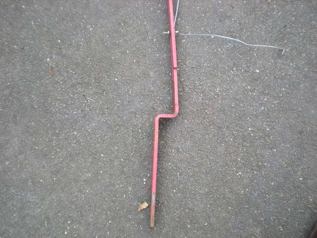

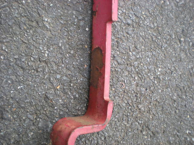

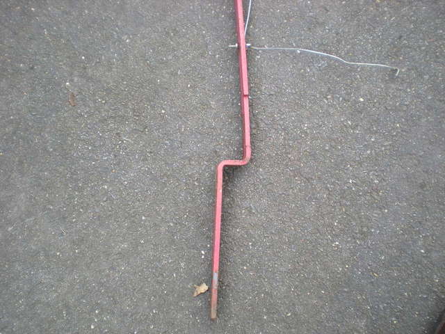

shallowwatersailor 3,219 #9 Posted November 28, 2015 (edited) Bob, I can't really tell from your photos. I had to get a different lever when I bought my 42" plow for the C-Series at the show a few years ago. It came with a "straight" lever that interfered with the brake pedal on the right. I bought this handle at Lawson's in New Market. It has the bend and also a notch for clearance. The photos are the front side. Edited November 28, 2015 by shallowwatersailor Share this post Link to post Share on other sites
