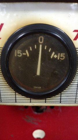

RedRanger 1,470 #7 Posted December 9, 2015 Is this AMP gauge a correct original to a 702 or has the original been swapped out? I'm accustomed to seeing SW gauges in these. Share this post Link to post Share on other sites
ri702bill 10,595 #8 Posted December 9, 2015 Red: Yes, that is the original correct style for a 702. I did swap mine for a later chrome bezel style, only because the needle "bounces" too much at anything less than wide open throttle. A couple of other things - don't forget to look at the frame attachment plate to the Uni-drive. If the tractor did much plowing as mine did, some or all of the 4 mounting holes can be cracked due to torsional stress twisting the frame. Same goes for the lower cast iron steering mount - one or both ears can be broken off. Sometimes hard to see on a 702, as there is a bent strap that goes from the hood stand under the dash over the top of the ears. Part of owning a Round Hood .......... Bill 1 Share this post Link to post Share on other sites
RedRanger 1,470 #9 Posted December 9, 2015 23 minutes ago, ri702bill said: Red: Yes, that is the original correct style for a 702. I did swap mine for a later chrome bezel style, only because the needle "bounces" too much at anything less than wide open throttle. A couple of other things - don't forget to look at the frame attachment plate to the Uni-drive. If the tractor did much plowing as mine did, some or all of the 4 mounting holes can be cracked due to torsional stress twisting the frame. Same goes for the lower cast iron steering mount - one or both ears can be broken off. Sometimes hard to see on a 702, as there is a bent strap that goes from the hood stand under the dash over the top of the ears. Part of owning a Round Hood .......... Bill Thanks Bill. I've got this tractor in pieces right now and from what I've seen, the frame shows very little wear or abuse. I do have to fix some play in the steering and the upper steering shaft bushing/bearing. No cracks though. That AMP gauge looks period correct, but the black bezel almost looks new, so I was wondering. Thanks for the info. Steve Share this post Link to post Share on other sites
