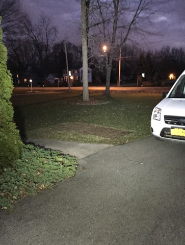

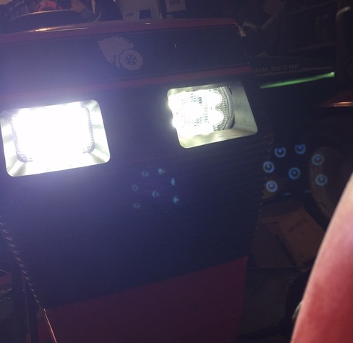

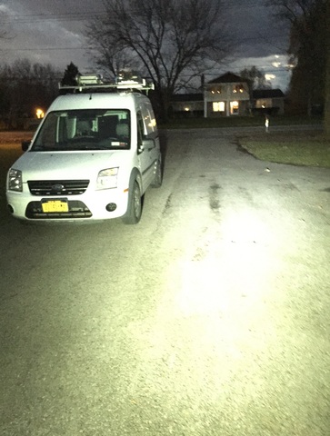

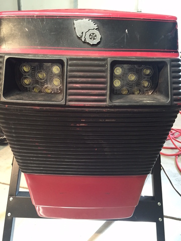

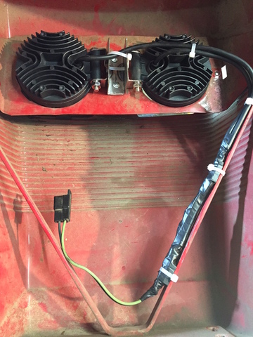

WNYPCRepair 1,923 #1 Posted November 20, 2015 I bought these off Amazon. Cheap, but they are still better than the original headlights. I wanted something that would fit in the same holes. http://www.amazon.com/gp/product/B00UYMRNOU?psc=1&redirect=true&ref_=oh_aui_detailpage_o04_s00 Made a little U shaped bracket, welded the light brackets to it, screwed it to the headlight support. Original wiring intact. My light meter on my phone showed 792 Lux with the originals, 185944 with the new ones. 6 Share this post Link to post Share on other sites

DougC 2,643 #4 Posted November 20, 2015 Oh, I like the way the light is focused. You got those mounted perfectly. Do they seem to be made relatively weather proof in your opinion? Share this post Link to post Share on other sites
WNYPCRepair 1,923 #5 Posted November 20, 2015 Oh, I like the way the light is focused. You got those mounted perfectly. Do they seem to be made relatively weather proof in your opinion? They say waterproof, and they look like they will hold up to normal weather Share this post Link to post Share on other sites
