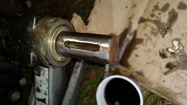

ferguson65 71 #56 Posted February 1, 2016 (edited) 33 minutes ago, Xearl said: Way to go , it looks like you are ready now I just finished doing the idlers yesterday along with a new chain ( Tractor Supply ) . Greased everything up and finally buttoned it up . I did the seals this past summer on my 518xi . Went for a walk today and there were people in shorts even a few motorcycles . I was working on my truck in the driveway in a t shirt. Crazy for January. The axle seals are for when I get to repairing (welding) the shafts. I've got new keys, setscrews and seals waiting and ready to go. One of the transaxle mount bolts is broke, so I will probably pull the whole thing and do the repairs on a bench. Just can't down my snowblower to do it in winter, and still need to source a hub. Hoping to find a good used one rather than buy new. Edited February 1, 2016 by ferguson65 1 Share this post Link to post Share on other sites
Xearl 132 #57 Posted February 1, 2016 Just to let you know how I fixed my enlarged keyway on my 518XI. I bought a piece of brass ( I believe it was 1/4" w x 1" h) stock and cut it to length . I clamped it in place and my friend Tig welded next to it with the axle in the tractor . I bought a new hub because the old one was egg shaped . 1 Share this post Link to post Share on other sites
ferguson65 71 #58 Posted February 1, 2016 That's exactly what I plan to do Earl. Your post gave me hope for a fix without replacing the axles when I found a few months back! Share this post Link to post Share on other sites
