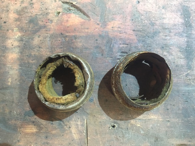

WNYPCRepair 1,924 #34 Posted January 11, 2016 Better check the bearings. I had to replace the ones on both ends of the augers, and the ones on the jack shaft between the pulley and chain sprocket up top, and my shaft was eaten up too Share this post Link to post Share on other sites
ferguson65 71 #35 Posted January 11, 2016 Just now, WNYPCRepair said: Better check the bearings. I had to replace the ones on both ends of the augers, and the ones on the jack shaft between the pulley and chain sprocket up top, and my shaft was eaten up too Quote I went over it good last year before I put it on and all looked good, but while I'm doing the chain it'll get another once over. We don't get the kind of snow and usage here like you get in Buffalo though! 1 Share this post Link to post Share on other sites
WNYPCRepair 1,924 #36 Posted January 11, 2016 (edited) These are the auger bearings from mine. The edges are bent from the punch I had to use to drive them out of the flanges, otherwise this is what they looked like. They were probably good for another few hours, but I decided to change them before they got too bad, LOL Edited January 11, 2016 by WNYPCRepair 1 Share this post Link to post Share on other sites
