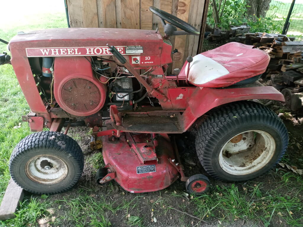

Jason X 20 #9 Posted June 6, 2021 Rescued from dad's scrap pile. Rebuilt the carb.started right up. Just a plugged needle valve. Deck was shot but I can weld so I started looking for deck parts. Guys were crazy. Bidding wars for parts! Thought it was destined to be a go kart or I would have to retrofit a different brand deck. But found a John Deere tractor owner who had my deck (one year newer?)under it. Didn't know what he had. Paid $75 and $75 to freight ship it to me. Snapped right in. Looks like some rollers were added to it. Dad bought it in '83 junked it in 88. Can't kill it. Took wheel bar off old deck put on this one after I removed back rollers. Share this post Link to post Share on other sites

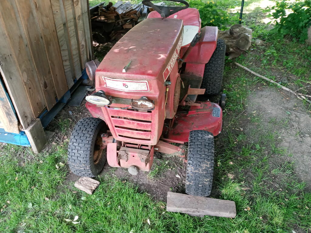

Jason X 20 #10 Posted June 6, 2021 Lights aftermarket. Obviously. Will be removing. Found plow and snowblower for $45 total with the flag. Share this post Link to post Share on other sites
Jason X 20 #11 Posted June 6, 2021 Also told rear tire size is not made anymore. Share this post Link to post Share on other sites
