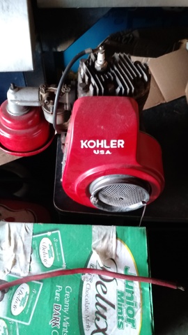

Brian01 481 #52 Posted November 20, 2015 (edited) I have the original engine, just needs some care. Yes, I agree, really need to leave this one be, and find one with original patina. Edited November 20, 2015 by Brian01 Share this post Link to post Share on other sites

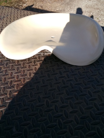

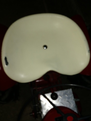

Brian01 481 #59 Posted November 23, 2015 Any suggestions on painting a seat? No matter how hard I try n keep paint on it, at least once a month I or someone else sits on it, it ends up chipping or flaking paint off. As I said before it has primer, black then antique white. It happened yesterday, so I repainted again, then sanded it down with 60 grit lightly, hoping that maybe if its dull and a little rough, that it won't do it again.. Share this post Link to post Share on other sites
Brian01 481 #60 Posted November 24, 2015 Well, the seat turned out like poo again, so I touched it up a but again and clear coated it this time, hopefully that helps, letting it dry good over night, may put another coat or two on tomorrow, if needed. Share this post Link to post Share on other sites

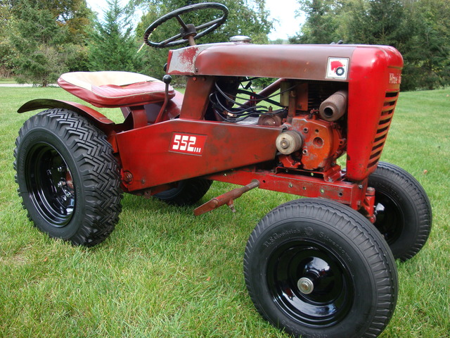

Zeek 2,299 #61 Posted November 24, 2015 (edited) The other guys summed it up pretty well. I had original paint and wet sanded it with 320. Wash/dry/clear coat. Lasts for years. I used this tractor on a regular basis. It was just hauling a firewood cart Sunday! Had the seat resewn too, but that's not in the photo. Edited November 24, 2015 by Zeek 4 Share this post Link to post Share on other sites
Brian01 481 #62 Posted November 24, 2015 That looks great! Share this post Link to post Share on other sites

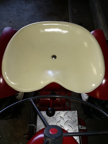

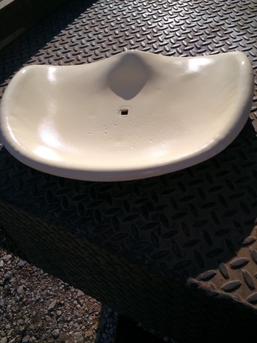

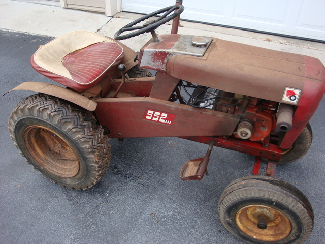

Brian01 481 #64 Posted November 24, 2015 Pretty interesting...I read it the other day.. I've decided to just leave the RJ the way it is and find me a Tractor that already has some patina. I done the places that are going to wear anyways..looks good actually, gave it some character. I messed with the seat all day yesterday, trying to get it to look right. Where it had chipped off everywhere. Hoping this last fix does it. Put antique white over the bad places, couple coats of clear, then more white, then couple more of clear. Its curing now..should have enough clear under and on top that it wont scratch and chip all the time...we'll just havfta wait n see i guess.....Here are some pics of before and after , 1 Share this post Link to post Share on other sites
