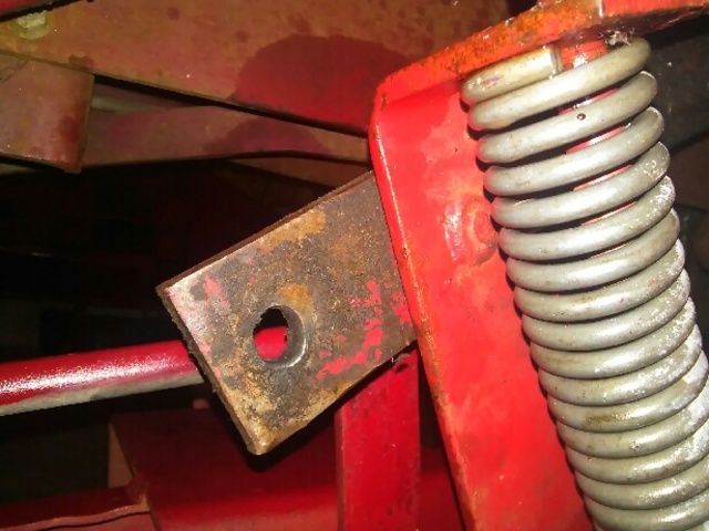

rexman72 210 #1 Posted November 18, 2015 is two inchs off the ground with the hydro lift all the way down and the bracket is in the 2nd slot .Any ideas to whats going on? Share this post Link to post Share on other sites
gwest_ca-(File Mod) 11,445 #2 Posted November 18, 2015 Here is a 1974 manual. Perhaps that will helphttp://www.wheelhorseforum.com/files/file/1916-blade-dozer-56in-1974-6-1141-om-ipl-snpdf/Garry Share this post Link to post Share on other sites
rexman72 210 #3 Posted November 18, 2015 I just took out the free floating bolt and the blade came right down to the ground Share this post Link to post Share on other sites
tractorhogg 612 #4 Posted November 18, 2015 which one was the free floating bolt on the manual? Thanks Share this post Link to post Share on other sites
rexman72 210 #5 Posted November 18, 2015 If you go to the file that garry sent there is figure 6 and it tells about the float lock out pin.I took that pin out and the blade comes down 1 Share this post Link to post Share on other sites
