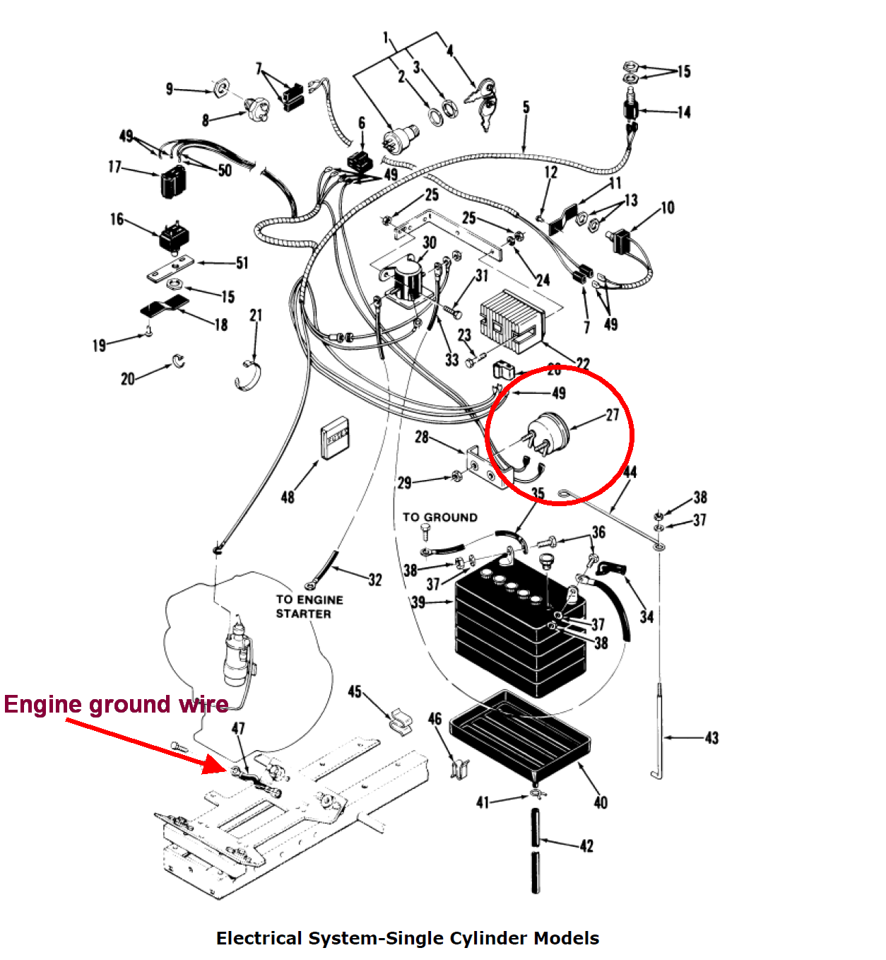

rmaynard 16,699 #8 Posted November 18, 2015 Start the whole troubleshooting process by making sure that you have a good ground connection between the battery (-) post and the engine/frame.Have you checked the 25 amp fuse that is located between the solenoid and the ammeter? The reason I said to check the ground connection is that the isolation mount for that engine is notorious for developing a poor ground. The battery (-) connects to the frame, then the engine cradle is grounded to the frame through a wire, not a direct connect like previous and later models. Share this post Link to post Share on other sites
rmaynard 16,699 #9 Posted November 18, 2015 Look at the image above. Item 47 is the wire that grounds the cradle to the frame. The red circle is your ammeter. If the ammeter is bad, you will have no voltage at the ignition switch. It can be bypassed by connecting both wires together. And as I said earlier, don't forget about the 25 amp fuse. Share this post Link to post Share on other sites
