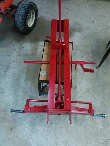

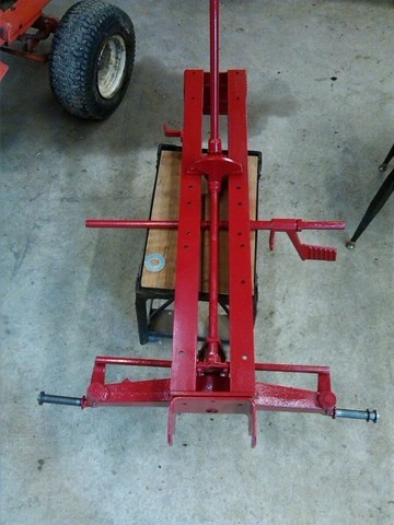

Cole J. 71 #104 Posted June 4, 2016 All right so I got the steering linkage painted and reinstalled, at some point next week, if my dad hold up to his word the still busted axial will be fixed and remilled down at the local foundery. And all the bigger peaces like the hood and fenders are going to be striped down to bear metal and primed because it wouldn't look very good with a bunch of little pits from the old paint. I must say that Rust-Olium profesional series paint gives a nice glossy finish. 4 Share this post Link to post Share on other sites
