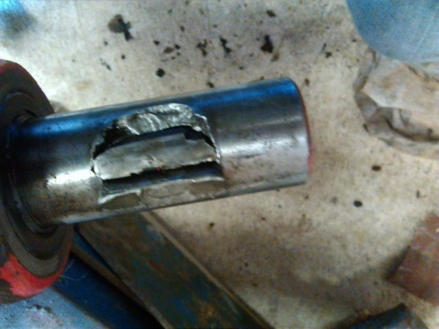

Cole J. 71 #77 Posted February 21, 2016 Well I thought today would be a good day to work a little and desided to take off the back wheels and check for slop in the axial. I thought what the heck i will pull the hubs as well. The good thing is there is no slop. Any way to fix this or an i going to have to get a new one ... i would really like to not have to do that. Thanks Share this post Link to post Share on other sites

Achto 32,548 #79 Posted February 24, 2016 I had to do some repairs to the axel on mine. Wasn't near that bad though. I removed the axles and machined a new slot 180 degrees from the old key way, then used a strait key instead of the half moon key. Made it nice and long so the new key would stretch past any damage in side the hub also. This made my hubs rock solid on the axle again. I realize not everyone has access to fancy equipment. If you don't, take your axles & hubs to a machine shop in your area. They should be help you out. If you do this make sure you leave enough solid shaft for the axle seal to ride on. The slot I cut in mine stops 3/16" before the seal. Share this post Link to post Share on other sites

Cole J. 71 #83 Posted March 2, 2016 So back to the busted up axial I was look at the hub and in the key way where the key sit the key way opens wider than the rest of it. Is this supposed to do that? Because the other hub is not like that but it is a different type. Share this post Link to post Share on other sites
Ed Kennell 47,133 #84 Posted March 2, 2016 (edited) The key slot should be a constant width. If it is wider in the key area, it is worn ...probably from the broken axle keyway allowing the key to move. You can have new keyways cut in the hub and axle at most machine shops. As stated above, I have successfully repaired the axle keyways by welding, but I would not attempt it on the cast iron hub. Edited March 2, 2016 by ekennell 1 Share this post Link to post Share on other sites
Cole J. 71 #85 Posted March 2, 2016 OK it's weird I suppose it could just be the wearing over time but it looks as though it was meant to be there because it is perfectly straight. I suppose if it broke a while ago it would look like that from wear. Share this post Link to post Share on other sites
Achto 32,548 #86 Posted March 2, 2016 Judging by the way your axle looks, I would search for a different hub or have a new keyway cut into your old hub. If you fix the axle and put a wore out hub on you will damage your axle again. Share this post Link to post Share on other sites
Cole J. 71 #87 Posted March 2, 2016 Yeah I figured that, I will have to see what I can find. Share this post Link to post Share on other sites

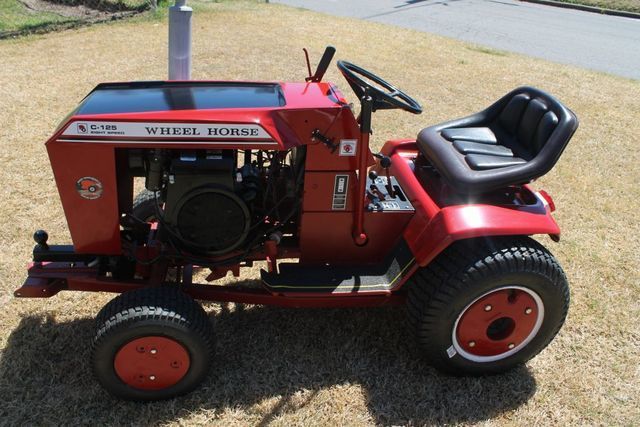

Daddy Don 912 #92 Posted April 1, 2016 Welcome to the club. You will get hooked. I just finished my third one. It is a c125 1981. Just take your time and you will love the end when it is finished. 2 Share this post Link to post Share on other sites
Cole J. 71 #93 Posted April 1, 2016 Thanks for the welcome, nice job, I have all ways like the look of that tractor thanks for sharing some pics as well it keeps me motivated to keep on working at it. Share this post Link to post Share on other sites

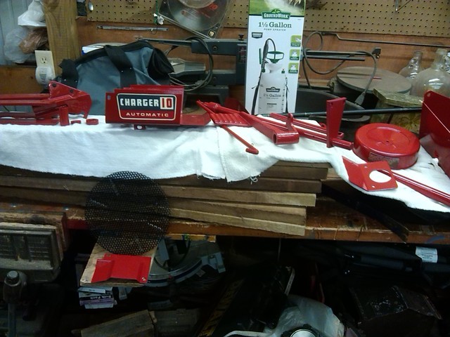

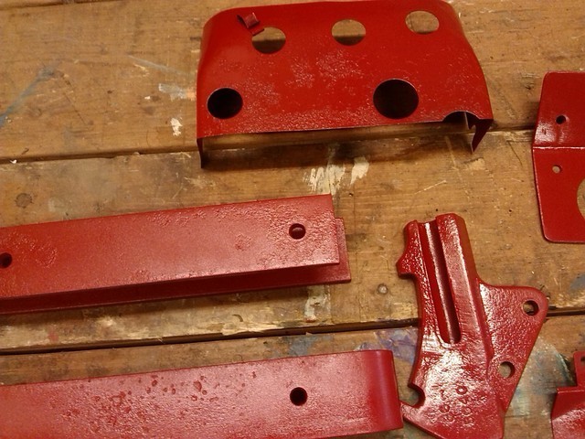

Cole J. 71 #94 Posted April 19, 2016 I tried my hand at painting, I'm using regal red. I haven't painted for a while and it shows, the few parts I painted didn't turn out all to well. I'm going to try again and will update then. 3 Share this post Link to post Share on other sites
953 nut 68,882 #95 Posted April 19, 2016 A couple of coats of sand-able primer and wet sanding with 400 W?D paper will help fill those pits and give a better finish. 2 Share this post Link to post Share on other sites
Cole J. 71 #96 Posted April 19, 2016 Could I get some cheap primer for the smaller parts, I have some for the larger parts. Would it still work like more expensive primer. Share this post Link to post Share on other sites
953 nut 68,882 #97 Posted April 20, 2016 Be sure it is sand-able, also it is best to stay with the same brand you will be using for top coat. 3 Share this post Link to post Share on other sites
RedRanger 1,470 #98 Posted April 21, 2016 Primer is for adhesion, not filling rust pits. Those parts need more than primer if you want to smooth them out. Look into body fillers. 1 Share this post Link to post Share on other sites

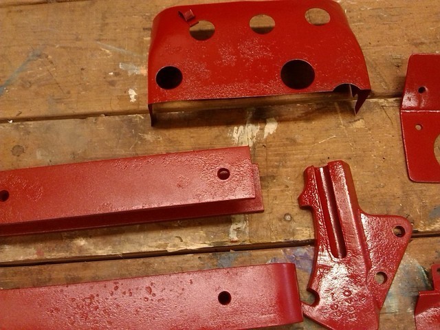

Cole J. 71 #99 Posted June 1, 2016 Its been a long time since my last update finally now that schools over I've been crackin' down hard on it ... well until i ran out of paint. Im getting some more today and im hoping to get done painting in a week or two, i got to get a gun to shoot primer on the hood and fenders. Thats what i have done so far, i figured out that the first atempt at painting i was to far away from the part and it wasnt covering evenly. Thats all for now another update in a few weeks. Sorry of the bad spelling 2 Share this post Link to post Share on other sites
