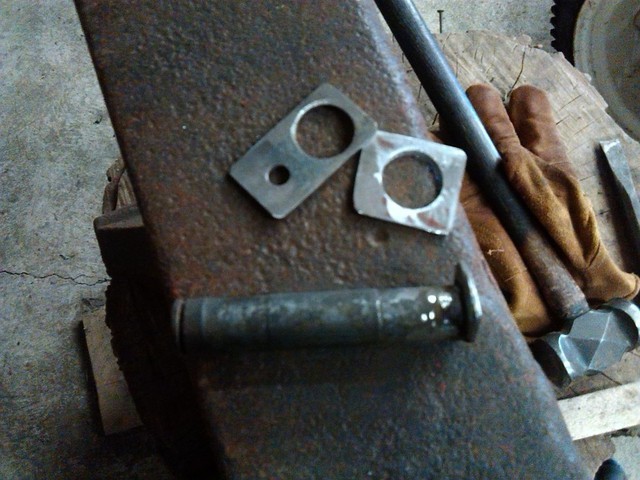

Cole J. 71 #57 Posted February 14, 2016 It been a while since I have given a status report on how I have been doing but it really isn't much, just if it wasn't so cold I would do something but anyway I have it stripped down to almost nothing and need to pressure wash it again before primer and paint goes on I had to fabricate a few new pieces. One was the front axial support pin, I don't know whatever you call it. Then the amp meter plate because it was broke in half. Share this post Link to post Share on other sites
grine_22 145 #58 Posted February 14, 2016 4 minutes ago, Cole J. said: It been a while since I have given a status report on how I have been doing but it really isn't much, just if it wasn't so cold I would do something but anyway I have it stripped down to almost nothing and need to pressure wash it again before primer and paint goes on I had to fabricate a few new pieces. One was the front axial support pin, I don't know whatever you call it. Then the amp meter plate because it was broke in half. Did u get a new amp meter plate made already? Share this post Link to post Share on other sites

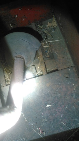

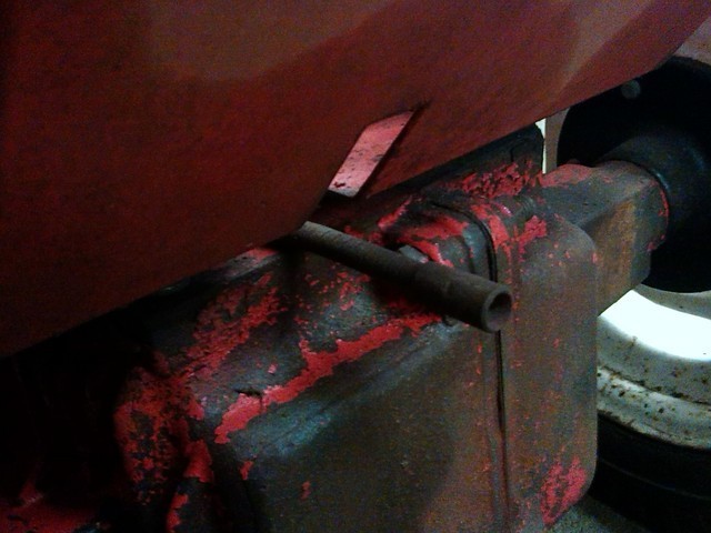

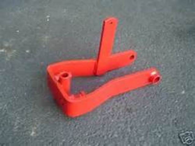

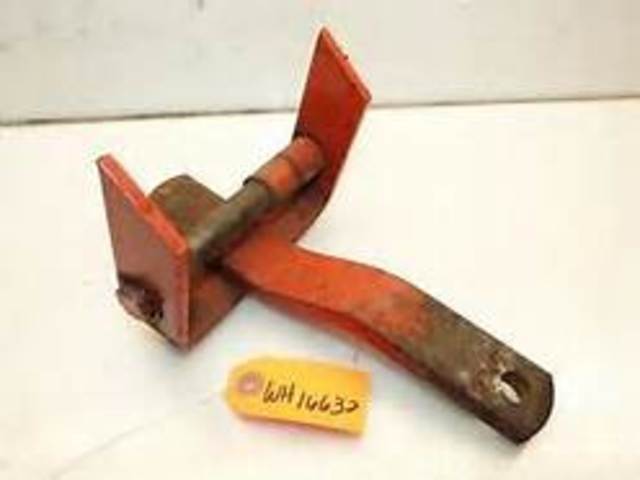

Cole J. 71 #59 Posted February 14, 2016 I also have a question, on the back of the tractor is a little rod of some sort that sticks out past the back pan, when I toke the pan off the rod wasn't connected to anything and didn't look like it had a place to go. What is this? Share this post Link to post Share on other sites
russellmc301 601 #60 Posted February 14, 2016 to me looks like a hitch pin that hold the hitch in place. 1 Share this post Link to post Share on other sites
Cole J. 71 #61 Posted February 14, 2016 This one wrong pic sorry my phone is being stupid. The first one is the axial pin Share this post Link to post Share on other sites

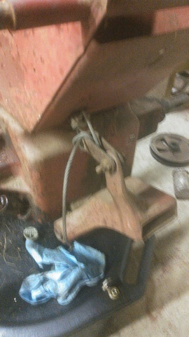

grine_22 145 #62 Posted February 14, 2016 2 minutes ago, Cole J. said: I believe a more experienced member will chime in but I believe its the lift mechanism going to the hitch. A cable slides through that small pipe and attaches to the hitch and the front goes to the lift handle on the tractor. Share this post Link to post Share on other sites
Cole J. 71 #63 Posted February 14, 2016 11 minutes ago, grine_22 said: Did u get a new amp meter plate made already? Yes I don't have a picture, I couldn't find it I made it a while ago. My organization is terrible I need to regroup everything 2 minutes ago, grine_22 said: I believe a more experienced member will chime in but I believe its the lift mechanism going to the hitch. A cable slides through that small pipe and attaches to the hitch and the front goes to the lift handle on the tractor. Hum could be I'm not sure if that would work though because it dead ends to the shifter box I would have to look at it again Share this post Link to post Share on other sites
grine_22 145 #64 Posted February 14, 2016 14 minutes ago, Cole J. said: Yes I don't have a picture, I couldn't find it I made it a while ago. My organization is terrible I need to regroup everything Hum could be I'm not sure if that would work though because it dead ends to the shifter box I would have to look at it again The picture of the shifter flipped on me for some reason, but the cable drops underneath the panel and goes to the lift lever on my tractor. Share this post Link to post Share on other sites
Cole J. 71 #65 Posted February 14, 2016 All right I will look to marrow maybe that could be since i dont even have a manual shift box it hydrostatic. I will look at that. Share this post Link to post Share on other sites
Racinbob 13,250 #66 Posted February 15, 2016 That cable connecting to the slot hitch runs to the lowest hole on the lift arm rock shaft. It does indeed run through that tube. Share this post Link to post Share on other sites
Cole J. 71 #67 Posted February 15, 2016 That's weird because I don't have that type of hitch, well I suppose it could be interchangeable Share this post Link to post Share on other sites

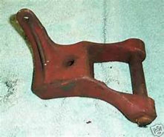

Racinbob 13,250 #68 Posted February 15, 2016 I suspect you have a drawbar hitch like this based on not having a cable slot hitch clevis hitch Share this post Link to post Share on other sites
Cole J. 71 #69 Posted February 15, 2016 Yeah I have a drawbar Share this post Link to post Share on other sites

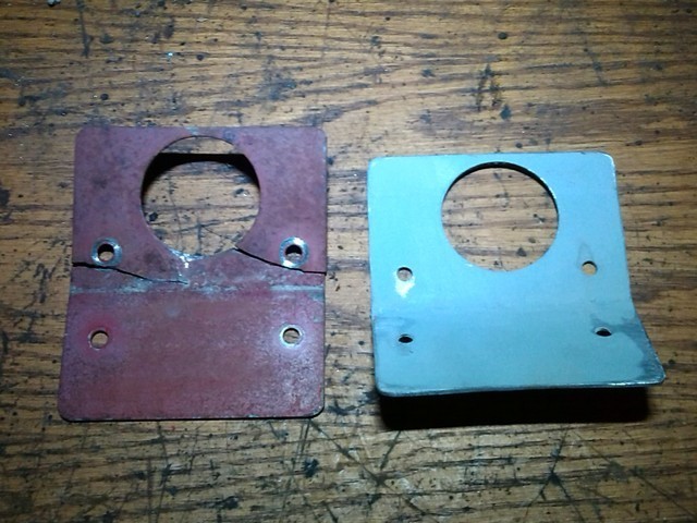

Cole J. 71 #70 Posted February 15, 2016 Here is the amp gauge plates the new one is slightly off center but other than that it turned out good I had to Make the old one flat to get a good measurement 2 Share this post Link to post Share on other sites
