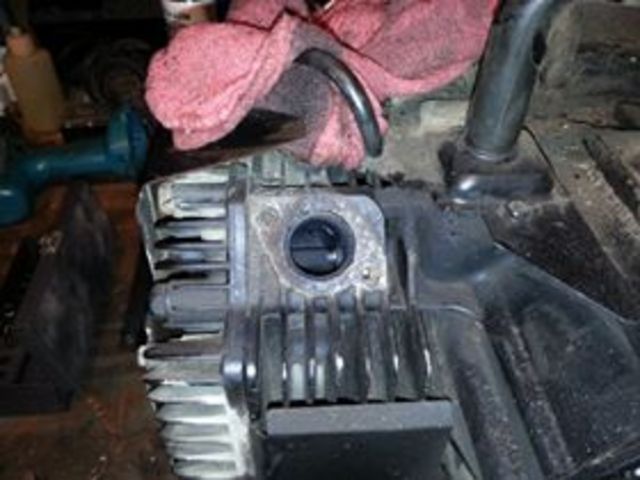

Rollerman 291 #39 Posted November 22, 2015 Success....after many disappointing nights not getting anywhere with this exhaust bolt, I finally got it out without breaking it. I wasn't having any luck with the dead blow impact, the center for the Allen tool was to ate away. I ended up using a chisel to break free the lock washer & relieve some of the pressure on the bolt...then with vice grips & some wiggling it started to free up. Now I can get busy prepping it for installation in my Steiner Turf Master. 1 Share this post Link to post Share on other sites
