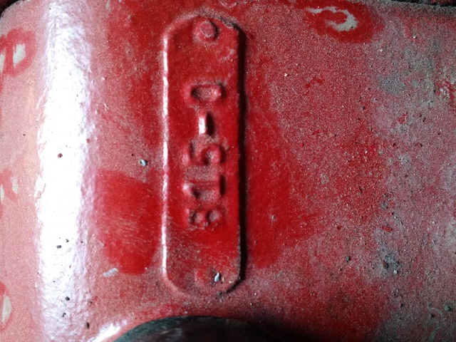

Brian01 481 #1 Posted November 13, 2015 Hey fellers, I just got to thinking bout this last night and this morning...never checked into it much, because I used a suburban 400 tranny on my RJ...the one that came on it was just a roller, all of its guts I got in a box.....anywho next to the shifter boot on the RJ transmission it is stamped " B15-0" can someone tell me what that means? Share this post Link to post Share on other sites
wallfish 19,367 #2 Posted November 13, 2015 The theory isB= Feb15 = 15th day0 = 1960 3 Share this post Link to post Share on other sites
Brian01 481 #3 Posted November 13, 2015 1960? Hm, so wouldn't actually be the original rj58 tranny either then right? The tab for the break mount is vertical (no angle, like a suburban) so I know its for an RJ. Share this post Link to post Share on other sites
stevasaurus 23,619 #4 Posted November 13, 2015 That date is a casting date for the cast part. Anyone could have changed the side plate which in essence would change it from a #5010 to a #5003. I have done that myself. It is also possible that the side plates are original and the casting is not. The ears where the side plates bolt on are very fragile and easy to break off. If someone did that, trying to fix the trans, a new casting would be an option. 3 Share this post Link to post Share on other sites

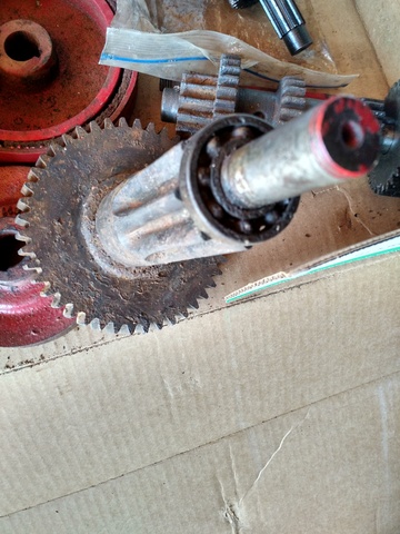

stevasaurus 23,619 #6 Posted November 13, 2015 Brian, how many teeth are at the small end of the brake shaft gear?? 8 or 11 Share this post Link to post Share on other sites
Brian01 481 #7 Posted November 13, 2015 Have no idea...its in my storage unit up town. Share this post Link to post Share on other sites
stevasaurus 23,619 #8 Posted November 13, 2015 If it is 8.. all the internal gears are from a 1958 RJ. If it is 11...it is still possible that the internal gears are from a RJ, either 1958 or 1959. Share this post Link to post Share on other sites
Brian01 481 #9 Posted November 13, 2015 Okorgive my ignorance, but what does the brake shaft gear look like?If I have time when igo get my boy from school, I'll run by n look at it. Share this post Link to post Share on other sites
stevasaurus 23,619 #10 Posted November 13, 2015 (edited) It is the large mushroom looking gear...the top part of that gear meshes with the differential. I might have a picture This picture happens to have the gear with 8 teeth at the top. Edited November 13, 2015 by stevasaurus 1 Share this post Link to post Share on other sites
Brian01 481 #11 Posted November 13, 2015 Yeah, mine has 8 as well, hard to see cause bearing is on there but.... 1 Share this post Link to post Share on other sites
stevasaurus 23,619 #12 Posted November 13, 2015 Well, congratulations Brian...that is from a #5003 transmission and a 1958 RJ. Guaranteed. Share this post Link to post Share on other sites
