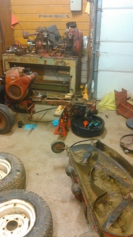

grine_22 145 #53 Posted February 26, 2016 Well I'm into it more than I figured I would go but there's a few things here and there that needed fixed so why not just finish the whole thing. 1 Share this post Link to post Share on other sites

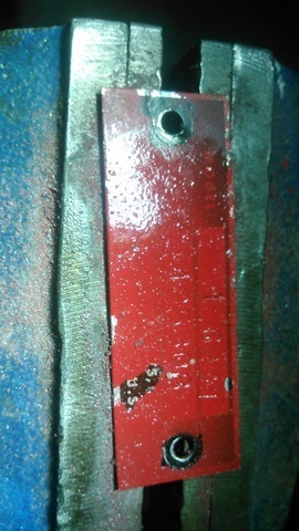

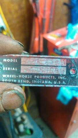

grine_22 145 #57 Posted March 2, 2016 On 2/27/2016 at 8:40 PM, Cole J. said: We just have a little pull barn and stuff is every where it is starting to bother me as well. Trust me it don't matter how much room there is, it will get filled! I've got my mower in parts in the one side so rooms getting limited. Got the I'd tag off, someone painted right over it . I put some brake fluid on and got it cleaned up a bit, It needs more work though. At least for its age its not in bad shape Share this post Link to post Share on other sites
Cole J. 71 #58 Posted March 2, 2016 I suppose that is true, never do have enough space, an idea I'm not sure if it will work much better but non-alcohol based astone (I think that's how it's spelled, finger nail polish remover) we use that when we wash our hands after painting something it takes paint off well Share this post Link to post Share on other sites
grine_22 145 #59 Posted March 2, 2016 I'll hafta do some checking and reading around. Contemplating whether or not to have the actual tag done or see if I can't find somewhere to get an aluminum replica tag made Share this post Link to post Share on other sites
Cole J. 71 #60 Posted March 2, 2016 Yeah that probably wouldn't be a bad idea since your going to have a nice fresh looking tractor with a messed up tag. Share this post Link to post Share on other sites
grine_22 145 #61 Posted March 2, 2016 Tractor won't be pristine, just a rattle can job so it can still work and get dirty. Practicing up for the next project I got lined up. 1 Share this post Link to post Share on other sites
Cole J. 71 #62 Posted March 2, 2016 Personally if its going to get worked and you aren't to worried about how clean it is i wouldn't worry about it, as long as you can see what it says Share this post Link to post Share on other sites
grine_22 145 #63 Posted March 2, 2016 Ill probably just order a replica and put the original up and if I ever restore it correctly it'll be on hand. Share this post Link to post Share on other sites

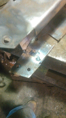

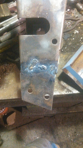

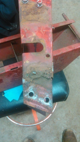

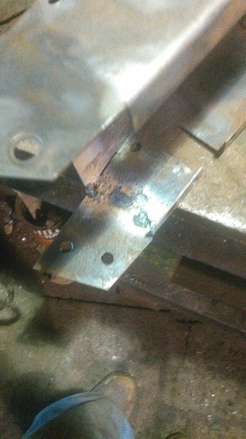

grine_22 145 #64 Posted March 6, 2016 So the dash tower had previously been "repaired" but the welds look like crap. I drilled the tack welds out of the one side and split it from the lower body cavity to work on it more easily. I'll Gri d the welds down and get them cleaned up and looking good. When I put it back together I'll either reweld it or figure out another way of keeping it together. 2 Share this post Link to post Share on other sites

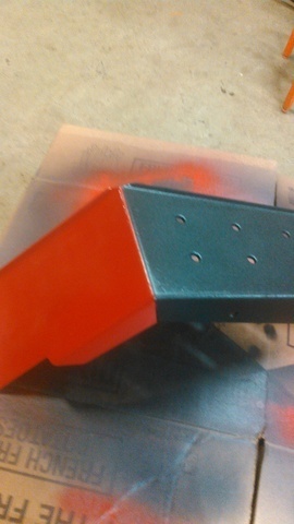

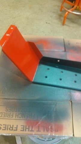

grine_22 145 #65 Posted March 13, 2016 The foot rests are getting painted while the weathers decent. Trying out some spray on bedliner, i taped off the tops of the footrests, we shall see how it turns out. 2 Share this post Link to post Share on other sites
Cole J. 71 #66 Posted March 13, 2016 I was going to do the same thing with mine I will be interested to see how it turns out Share this post Link to post Share on other sites
grine_22 145 #67 Posted March 14, 2016 1 hour ago, Cole J. said: I was going to do the same thing with mine I will be interested to see how it turns out 1 Share this post Link to post Share on other sites
grine_22 145 #68 Posted March 16, 2016 Very pleased with how the footrests turned out 4 Share this post Link to post Share on other sites

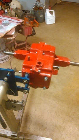

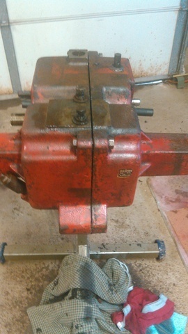

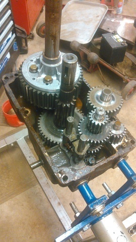

grine_22 145 #69 Posted March 22, 2016 Trans is off the horse, clean it up with some degreaser and water this week and I'll be ready to split it 3 Share this post Link to post Share on other sites

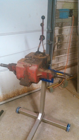

Pullstart 68,882 #70 Posted March 25, 2016 Is that an engine stand? Genius way to pull a case apart! I'll have to remember that when I find time to go through my 2 transmissions needing attention! Share this post Link to post Share on other sites
grine_22 145 #71 Posted March 25, 2016 4 hours ago, pullstart said: Is that an engine stand? Genius way to pull a case apart! I'll have to remember that when I find time to go through my 2 transmissions needing attention! It is. I was trying to figure out how to keep the transmission off the floor or bench so I still had room to work and it was sitting in the corner empty. Works out nice even when u split the case halves for a mobile workbench 5 Share this post Link to post Share on other sites

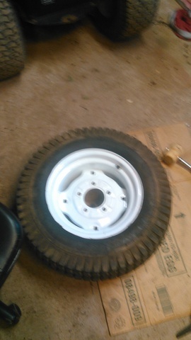

grine_22 145 #72 Posted April 4, 2016 Tires are splitting but I stuck the originals back on with new tubes because the tires have wheel horse stamped on them Share this post Link to post Share on other sites

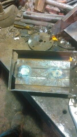

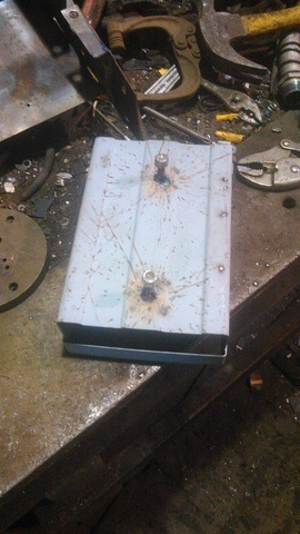

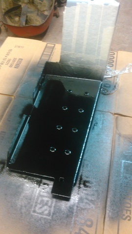

grine_22 145 #73 Posted April 10, 2016 The old studs on the battery box snapped when I unbolted it so instead of trying to find new ones I took bolts, cut the heads off, welded washers on and tacked them in place. The dash got ground down and had a few holes so I put a plate of brass on the back and filled them with welds. The wire welder is only flux so i have splatter to clean up but things are coming along slowly with work picking up. 1 Share this post Link to post Share on other sites
grine_22 145 #74 Posted April 22, 2016 Got the trans all finished and back together, now to get the frame stripped and painted and start assembling everything. 2 Share this post Link to post Share on other sites

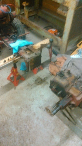

grine_22 145 #75 Posted October 25, 2016 Been a while, haven't had time to touch anything but with harvest about wrapped up I'll get back to things, the frame is disassembled and ready to be cleaned up and painted. Share this post Link to post Share on other sites
