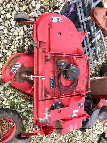

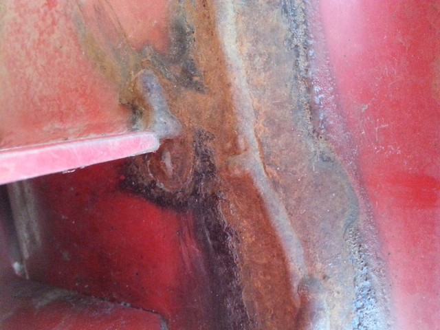

bmsgaffer 2,065 #26 Posted November 10, 2015 (edited) I've never looked under a 48" XI deck, but take a close look at your baffles... The rear one has an overlap joint... it is not this way on any classic that I have seen, always one piece. Also, the front baffles (which I thought were only installed when mulching?) do not match from left to right... one has a graceful bend, the other comes to a point...Like I said, never had one to compare to, but I think someone broke that one... They did a decent job fixing other than the 'caterpillar' welds so it shouldn't take much to fix. I would be real sure to check that it is level and square before fixing it up. I'd hate to put time into that and find that it doesnt cut evenly. Edited November 10, 2015 by bmsgaffer terrible spelling... 1 Share this post Link to post Share on other sites
953 nut 63,091 #27 Posted November 10, 2015 It seems to me that the dies used to stamp out these decks were probably the culprit. I have three 42" side discharge decks that all have had stress cracks around the spindle mounting area where there is an abrupt bend. Also, two have had stress cracks on the rear corners where the metal was stretched in the stamping process. I have had good results butt welding the cracks using the stitch welding method. For bolt hole stress cracks I have used 16 Gauge steel plates gap welded ( weld for 1/4', skip 1/2" weld 1/4" etc ), this distributes the stress to several points and reduces the likelihood of re-occurrence. 2 Share this post Link to post Share on other sites

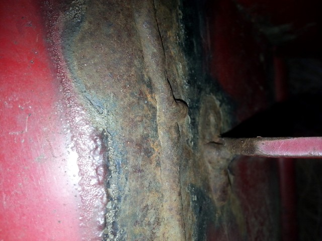

DennisThornton 4,772 #28 Posted November 10, 2015 I have two 42 sd decks that have extreme cracks around the center spindle.one deck lasted 15 years the second lasted only 5years.any idea about the main reason for this? Toolmanbill, I think most will agree with me that those spider cracks around the spindle are from unbalanced blades.And to everyone else following:I haven't checked to confirm that the deck frame/shell is true yet but I did take a closer look at the welds and for other damage. I still just don't get it. I see no signs of impact or that the welded area was realigned. If it were hit hard enough to rip open from the discharge all the way back another foot there surely would be some signs of bending, cracked paint/powder coat, hammer marks, impact marks but I see no other signs. I got to go with stress cracks. You can see at a brace where the weld has cracked and there's a small crack missed on one side. You'll probably have to click it or load the picture to enlarge it a bit Dennis,I have experienced the usual cracking around the lift areas on the 48" decks; your example is new to me on a WH. It almost looks like the deck have been used over some rough terrain and it bounced a lot. I have had that happen on a 46" deck on my dad's old Yardman garden tractor after a decade of use of mowing nearly four acres, twice a week. It is either that or that gauge wheel caught a hold of something that was immovable or much heavier. I have two 42 sd decks that have extreme cracks around the center spindle.one deck lasted 15 years the second lasted only 5years.any idea about the main reason for this? I agree. It's as though it has to be stress cracks but they couldn't be that bad and THAT local. I did find another crack but it too is at least close by. The rest of the deck is crack free! Got me confused. Share this post Link to post Share on other sites

bds1984 1,506 #32 Posted November 11, 2015 Well, what ever caused it, I'm sure that you'll fix it. I've never thought about the blades being out of balance as a cause for that, but I suppose that after manifesting during years of use, a crack will form along any weakness in the metal's structure. Bizarre; I can't say I've ever had a blade be off balance enough to cause that sort of issue. If it were mine, I'd hit it with an angle grinder to smooth out that 'caterpillar' and balance the blades. Share this post Link to post Share on other sites
DennisThornton 4,772 #33 Posted November 11, 2015 Well, what ever caused it, I'm sure that you'll fix it. I've never thought about the blades being out of balance as a cause for that, but I suppose that after manifesting during years of use, a crack will form along any weakness in the metal's structure. Bizarre; I can't say I've ever had a blade be off balance enough to cause that sort of issue. If it were mine, I'd hit it with an angle grinder to smooth out that 'caterpillar' and balance the blades. I have two 42 sd decks that have extreme cracks around the center spindle.one deck lasted 15 years the second lasted only 5years.any idea about the main reason for this? Impact perhaps or repeated rough terrain might have but unbalanced blades didn't do this! I'm going to grind what I can reach, make it as pretty as practical and use it. I'll watch and revisit if required. Share this post Link to post Share on other sites
ferguson65 71 #34 Posted November 11, 2015 Dennis, just found this, your deck's crack at the height adjuster wheel----the long rounded caterpillar weld looks just like mine does, well my weld looks a bit nicer, but the crack was the same. I've got to believe its stress cracking from rough ground, even stepping onto that side of the deck. The metal deck stamping is just too thin for the abuse those height wheels can dish out with nothing to tie the front and rear together IMO. Mine has even met a few trees here and there, but has held up since I braced it. I've got the lift brackets tearing out too, can't remember if I reinforced those or just rewelded them. I'll post pics of my frankendeck Saturday. 1 Share this post Link to post Share on other sites
DennisThornton 4,772 #35 Posted November 11, 2015 Dennis, just found this, your deck's crack at the height adjuster wheel----the long rounded caterpillar weld looks just like mine does, well my weld looks a bit nicer, but the crack was the same. I've got to believe its stress cracking from rough ground, even stepping onto that side of the deck. The metal deck stamping is just too thin for the abuse those height wheels can dish out with nothing to tie the front and rear together IMO. Mine has even met a few trees here and there, but has held up since I braced it. I've got the lift brackets tearing out too, can't remember if I reinforced those or just rewelded them. I'll post pics of my frankendeck Saturday. I have two 42 sd decks that have extreme cracks around the center spindle.one deck lasted 15 years the second lasted only 5years.any idea about the main reason for this? I'm not sure what ALL the quoting is about (seems like more than your message) but I'm all ears and eyes for what you are about to share.Thanks! Share this post Link to post Share on other sites
bmsgaffer 2,065 #36 Posted November 11, 2015 Stepping on it... I'll bet thats it. Some hefty fella was using that side as his step ladder for 15 years. That mixed in with the heavy duty wear and tear a mower deck sees anyway and voila, crack. 1 Share this post Link to post Share on other sites
ferguson65 71 #37 Posted November 17, 2015 Stepping on it... I'll bet thats it. Some hefty fella was using that side as his step ladder for 15 years. That mixed in with the heavy duty wear and tear a mower deck sees anyway and voila, crack. Not sure if you're doubting or trying to be funny.............................These 48" xi decks are kind of a joke compared to the rest of the tractor.Anyway, Dennis here are the pics of what I did to my deck. I had to take the flamewrench to my angle support to clear the bagger belt. But I can bounce up and down on the right side and it does not give at all now (I really did try it). I just rewelded the cracks at the lift point mounts and they look intact still. The long crack going out to the discharge is kind of a crappy weld and did crack again. I'll clean it up real good this winter and inspect / reweld / blades, etc. I had leaves to deal with and 4 hours to do it in so it was bagger on and go.Angle stitched to deck and welded to height adjusterHeight adjuster bracket gussets to deck pan. Inner had to be short to clear belt guardCrack on top of deck--cracked again, but must have been the first weld I did. that day.Full right side view of how I tied the front gauge wheel bracket to the rear height adjusterLeft side viewHope some of this may help. Seems to have fixed most of my headaches with it. I used flux core and didn't take much time to clean splatter, function over form for me. 2 Share this post Link to post Share on other sites

bmsgaffer 2,065 #39 Posted November 18, 2015 Stepping on it... I'll bet thats it. Some hefty fella was using that side as his step ladder for 15 years. That mixed in with the heavy duty wear and tear a mower deck sees anyway and voila, crack. Not sure if you're doubting or trying to be funny.............................These 48" xi decks are kind of a joke compared to the rest of the tractor. Nope, I was completely serious! You mentioned it and it went off like a light bulb in my head. I think you hit the nail on the head. I like your reinforcements, that deck looks quite solid now. Share this post Link to post Share on other sites
DennisThornton 4,772 #40 Posted November 18, 2015 Stepping on it... I'll bet thats it. Some hefty fella was using that side as his step ladder for 15 years. That mixed in with the heavy duty wear and tear a mower deck sees anyway and voila, crack. Not sure if you're doubting or trying to be funny.............................These 48" xi decks are kind of a joke compared to the rest of the tractor.Anyway, Dennis here are the pics of what I did to my deck. I had to take the flamewrench to my angle support to clear the bagger belt. But I can bounce up and down on the right side and it does not give at all now (I really did try it). I just rewelded the cracks at the lift point mounts and they look intact still. The long crack going out to the discharge is kind of a crappy weld and did crack again. I'll clean it up real good this winter and inspect / reweld / blades, etc. I had leaves to deal with and 4 hours to do it in so it was bagger on and go.Angle stitched to deck and welded to height adjusterHeight adjuster bracket gussets to deck pan. Inner had to be short to clear belt guardCrack on top of deck--cracked again, but must have been the first weld I did. that day.Full right side view of how I tied the front gauge wheel bracket to the rear height adjusterLeft side viewHope some of this may help. Seems to have fixed most of my headaches with it. I used flux core and didn't take much time to clean splatter, function over form for me. So your cracks were very much like the ones on my deck? The one on the chute opening sure looks like it! Share this post Link to post Share on other sites
Don1977 605 #41 Posted November 18, 2015 Stepping on it... I'll bet thats it. Some hefty fella was using that side as his step ladder for 15 years. That mixed in with the heavy duty wear and tear a mower deck sees anyway and voila, crack. Not sure if you're doubting or trying to be funny.............................These 48" xi decks are kind of a joke compared to the rest of the tractor.Anyway, Dennis here are the pics of what I did to my deck. I had to take the flamewrench to my angle support to clear the bagger belt. But I can bounce up and down on the right side and it does not give at all now (I really did try it). I just rewelded the cracks at the lift point mounts and they look intact still. The long crack going out to the discharge is kind of a crappy weld and did crack again. I'll clean it up real good this winter and inspect / reweld / blades, etc. I had leaves to deal with and 4 hours to do it in so it was bagger on and go.Angle stitched to deck and welded to height adjusterHeight adjuster bracket gussets to deck pan. Inner had to be short to clear belt guardCrack on top of deck--cracked again, but must have been the first weld I did. that day.Full right side view of how I tied the front gauge wheel bracket to the rear height adjusterLeft side viewHope some of this may help. Seems to have fixed most of my headaches with it. I used flux core and didn't take much time to clean splatter, function over form for me. So your cracks were very much like the ones on my deck? The one on the chute opening sure looks like it! That section of the deck is caring the weight of the deck with the height adjustment there. There isn't much support with the chute right there. Share this post Link to post Share on other sites
DennisThornton 4,772 #42 Posted November 18, 2015 Certainly much beefier now! I see how and why. Share this post Link to post Share on other sites

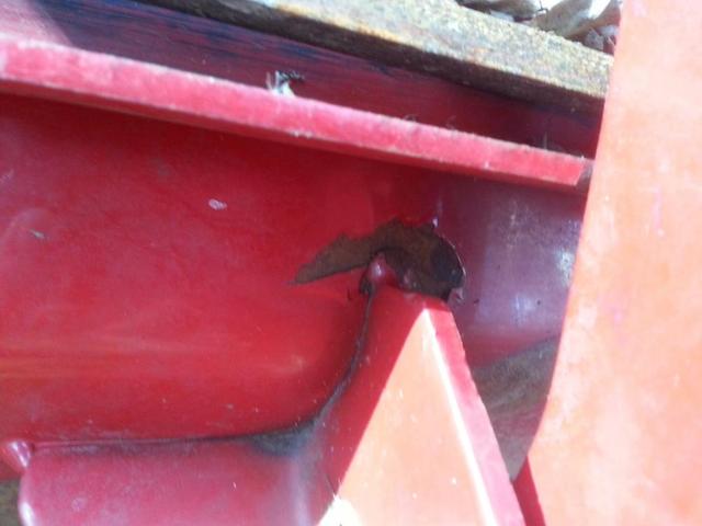

WNYPCRepair 1,923 #43 Posted December 13, 2015 (edited) Is this deck cracked in the same spot as yours? Edited December 13, 2015 by WNYPCRepair Share this post Link to post Share on other sites
DennisThornton 4,772 #44 Posted December 13, 2015 21 minutes ago, WNYPCRepair said: Is this deck cracked in the same spot as yours? Looks somewhat similar... Does it extend into the grass chute discharge area? Share this post Link to post Share on other sites
WNYPCRepair 1,923 #45 Posted December 13, 2015 I don't know, I saw it online and thought it looked similar. Share this post Link to post Share on other sites
Tankman 3,525 #46 Posted December 21, 2015 (edited) Stitch weld the cracks, Then stitch weld plates over the repaired areas. Found years ago, a Horse without a working deck was a $$$$ saver. Edited December 23, 2015 by Tankman Share this post Link to post Share on other sites
