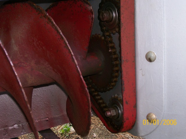

briankd 833 #3 Posted November 6, 2015 (edited) anyone have pictures of the drive chain and sprockets for routing chain I seem to have an extra sprocket on this at the top.looked at the parts break down and it don't show one there.do I need that sprocket ? also was thinking of changing the sprocket sizes to make it spin faster. would that hurt anything? Edited November 6, 2015 by briankd added to Share this post Link to post Share on other sites

gwest_ca-(File Mod) 11,763 #6 Posted November 7, 2015 Both idler sprockets are required.The chain travels from the bottom of the drive sprocket, down around the lower idler sprocket, up over the top idler sprocket, down under the auger sprocket and back to the top of the drive sprocket. This results in the auger rotating in the opposite direction as the engine crankshaft as required.I slowed my auger down. It is capable of pulling in more snow than can be discharged through the chute. When that happens the pressure of the snow on the plowed surface will lift the snowthrower off the ground and fire the snow back under the tractor.Garry Share this post Link to post Share on other sites
briankd 833 #8 Posted November 7, 2015 thanks for the info I think I will leave the sprocket diameters the way they are.you said it DougC this will be my winter project will have it done by spring and use it next winter I have my old 42" snow blade I will be using once again this winter. never know may not have the snow to use it anyway this winter. Share this post Link to post Share on other sites
