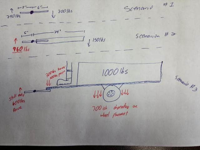

bmsgaffer 2,066 #41 Posted November 11, 2015 You will probably be fine, and I also understand that you are unlikely to change your mind (and that's OK! ), but I just have to put some physics in here for anyone looking at this thread in the future. If you stand on the hitch (lets assume the hitch is 6" long from the hitch pin to the hole, and extends 5" under the transmission, I dont know what the actual measurements are) you are putting a pressure of about 240lbs on the bottom of the transmission (not calculating forces on the pin, too much work, but expect it close). If you put 150lbs out free hanging 24" from that hitch pin you are exerting a pressure of 960lbs on the transmission bottom. Yours will not be quite that high since your 150lbs is distributed along the length of the 24", but it will be close. Its like using a giant breaker bar on a frozen bolt.Also keep in mind that trailers aren't valid comparisons as they have their own tires on the ground, so they are putting their tongue weight right at the hitch (the same as the first example I gave you of you standing on it) And that doesnt include the possibility of bouncing... you would be looking that thousands of lbs of force. 3 Share this post Link to post Share on other sites
Bigpat5123 28 #42 Posted November 11, 2015 You are right on point BMS. I definitely know what you are saying and respect everyone's reply's to my topic. I will be using this on my paved driveway so there will not be much cause for the hitch to bounce. We will see how it goes and hopefully I won't be needing help on repairs in January! 1 Share this post Link to post Share on other sites
diamondred 63 #43 Posted November 11, 2015 You will probably be fine, and I also understand that you are unlikely to change your mind (and that's OK! ), but I just have to put some physics in here for anyone looking at this thread in the future. If you stand on the hitch (lets assume the hitch is 6" long from the hitch pin to the hole, and extends 5" under the transmission, I dont know what the actual measurements are) you are putting a pressure of about 240lbs on the bottom of the transmission (not calculating forces on the pin, too much work, but expect it close). If you put 150lbs out free hanging 24" from that hitch pin you are exerting a pressure of 960lbs on the transmission bottom. Yours will not be quite that high since your 150lbs is distributed along the length of the 24", but it will be close. Its like using a giant breaker bar on a frozen bolt.Also keep in mind that trailers aren't valid comparisons as they have their own tires on the ground, so they are putting their tongue weight right at the hitch (the same as the first example I gave you of you standing on it) And that doesnt include the possibility of bouncing... you would be looking that thousands of lbs of force. Scenario #2.... Just my two cents, his weight distribution would be at the center of gravity of the 150 lbs, plus the center of gravity of the carrier......ok, I'm done. He did a nice job building the carrier, will definitely help. Share this post Link to post Share on other sites
