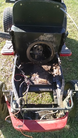

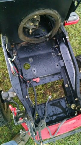

slammer302 2,156 #49 Posted November 7, 2015 do i unbolt the engine from the mounting plate or unbolt the plate and pull the hole thing out to clean the engine? Share this post Link to post Share on other sites
slammer302 2,156 #50 Posted November 8, 2015 took the engine out and cleaned it to day it was a all day project and it still not complete here is sum pics 4 Share this post Link to post Share on other sites
