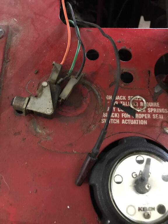

Stevie bdz 2 #19 Posted December 22, 2020 Thank you guys for all the info. I was able to manage some time today to look into the seat switch and I noticed the black wire was disconnected from the switch. That must have come off when I was messing with it the other day. But there is another wire just hanging out in there. Not sure yet what or where it goes. I took out the battery so I could get my eyes and hands in the pto switch area. I’m hoping to review the notes you guys gave and work my way through the testing procedures. I’ve attached a photo of the seat switch and misc. wire Share this post Link to post Share on other sites
Handy Don 15,772 #20 Posted December 22, 2020 It has a bullet connector on the end. The only other wiring back there on your tractor is for the taillights--is this the ground for them? The power for them is usually green. Share this post Link to post Share on other sites
