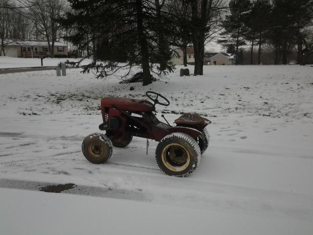

1964 704 20 #1 Posted November 3, 2015 Hi All, after tinkering around with my '64 704 for what seems like forever, I finally got it to the point that it is rideable and near completion. The original pull start motor had a sticking exhaust valve, so I replaced it with a later model k181 with the starter attached to it, converting it to electric start. Of course it had to be wired to make everything work, and I ended up using a motorcycle battery, since a standard garden tractor battery won't fit (starter encroaches into the battery box area). After searching this site, and discussing my options with other members, I decided to attach the regulator/rectifier via metal straps to right side of the frame above where the belt guard is (there are a couple of pre-drilled holes from the factory already there, so I bolted the straps there).I took it out yesterday for a shakedown run around my yard for about 25 mins with the only issue being the throttle will not lock in place. While working on it over this past year, It seemed like once I thought it was ready to go, something else would throw me a curve ball, (couldn't get it to rev past 1/2 throttle, governor not working, dead battery etc.) but it's all sorted now and running like a champ. It fires right up (after I figured out that full choke and about 1/4 throttle does the trick) and is reading a little over 14 volts when running, and the battery shows over 13 volts when I shut it off, so the charging system is functioning as designed. I can't tell you how elated I am that this 51 year old garden tractor is finally alive.This 704 is in it's original somewhat crusty patina, and I haven't decided if I should repaint it or not. I'm open to suggestions.Attached is a picture of it when I first got it in March or 2013, in the picture it has the original K161 motor with an aftermarket bolt on electric starter.Thanks to all that have provided suggestions in the past. 9 Share this post Link to post Share on other sites

SylvanLakeWH 30,616 #10 Posted November 3, 2015 This 704 is in it's original somewhat crusty patina, and I haven't decided if I should repaint it or not. I'm open to suggestions. Looks kinda tough as is, don't ya think? 1 Share this post Link to post Share on other sites

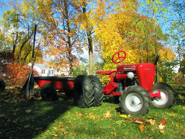

squonk 45,575 #12 Posted November 3, 2015 I've used my 704 for everything but a grocery getter. Here's my favorite glamour shot! 8 Share this post Link to post Share on other sites

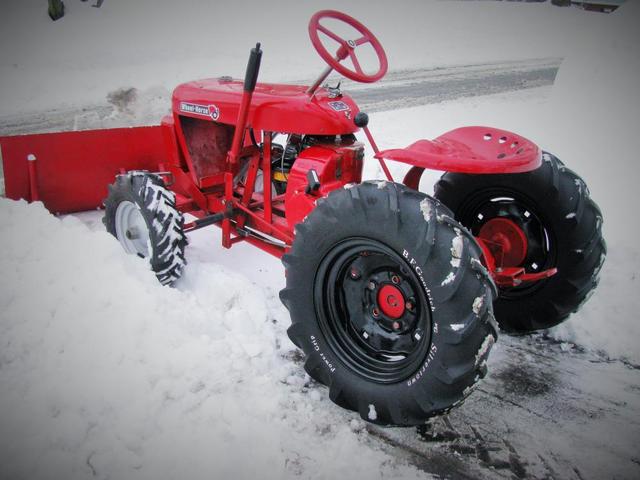

AMC RULES 37,254 #16 Posted November 3, 2015 Alright! Alright! I admit, I'm a fan of 'em. 10 Share this post Link to post Share on other sites

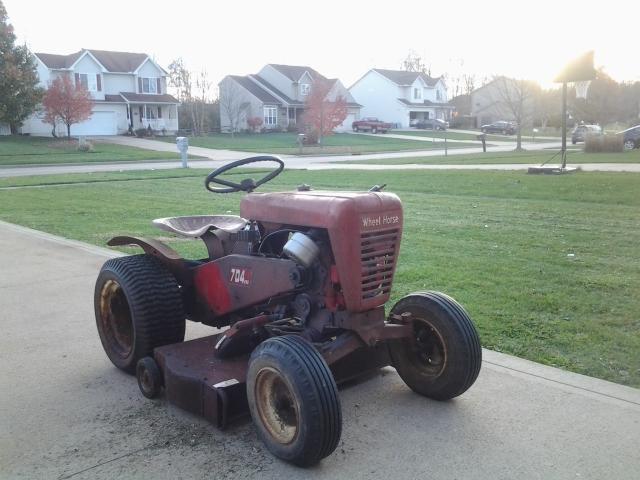

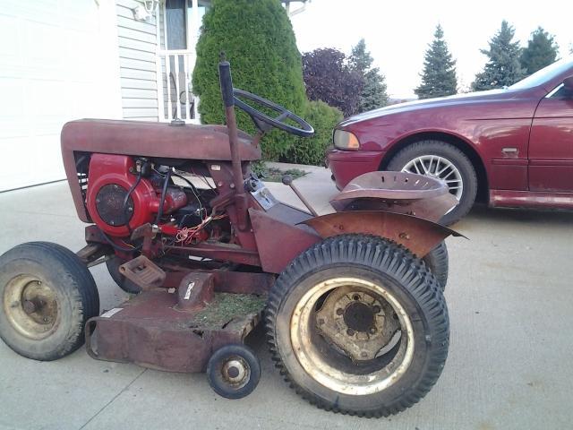

1964 704 20 #17 Posted November 9, 2015 Not only is it alive, I mowed my lawn today with it. Still a work in progress, but it's getting there slowly but surely. As promised, below are some pictures of the 704. 9 Share this post Link to post Share on other sites

Ken B 3,202 #19 Posted November 9, 2015 Looks pretty good as it is.. maybe the correct size and style rear tires and rims and a repaint of the rims... Share this post Link to post Share on other sites
1964 704 20 #20 Posted November 9, 2015 I have newish rear turf tires mounted on clean rims, just haven't put them on yet. These rear tires had been filled with calcium chloride, and it has rusted away the inside of the rims. Share this post Link to post Share on other sites
AlwaysLookin80 1,308 #21 Posted November 10, 2015 I like the patina. That's a cool 704. Very hard to find out by me. 1 Share this post Link to post Share on other sites
Brian01 481 #22 Posted November 10, 2015 I like the patina. That's a cool 704. Very hard to find out by me. i aagree, Do Not paint it, leave it be, awesome look! The red kohler engine tin, really stands out! Share this post Link to post Share on other sites
