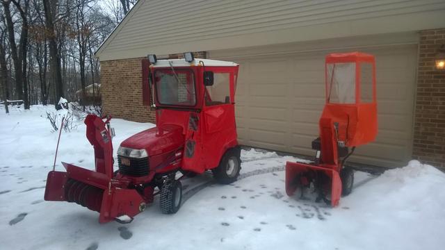

shallowwatersailor 3,222 #36 Posted November 3, 2015 (edited) Here is part of my crew from last year. I bought my glass windshield (painted the outside red) from a JD dealer online for less than the amount quoted. In my opinion it stiffens the cab up as well as being nice. The only thing is the vinyl window can be shaken to clear but you need the wiper on the glass windshield. Later in the season last year I found a source for the motorized windshield wiper for less than $100.00 and it will be replacing the manual one this year. I've got a few more goodies to add for this year's version.The Ariens cab came from the same JD dealer for way less than MSRP as well. I got tired of looking like a snowman! Edited November 3, 2015 by shallowwatersailor 6 Share this post Link to post Share on other sites

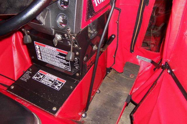

Ed Kennell 47,229 #38 Posted November 3, 2015 Doug, does your cab have a bracket that bolts the cab frame to the steering tower. My 520 cab has this and the 312 doesn't, and I can see a lot more swaying in the 312 cab.You can see the bracket here behind the PTO lever. 1 Share this post Link to post Share on other sites

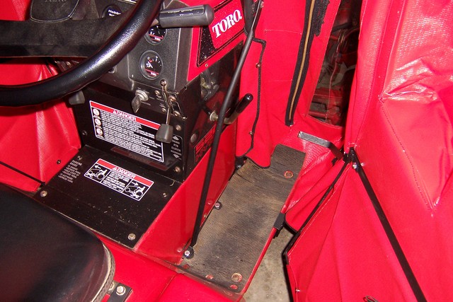

DougC 2,644 #44 Posted November 4, 2015 Doug, does your cab have a bracket that bolts the cab frame to the steering tower. My 520 cab has this and the 312 doesn't, and I can see a lot more swaying in the 312 cab.You can see the bracket here behind the PTO lever. Mine does not. My bracing is different utilizing existing holes in running board to right and left front supports as I hope you can see in my pictures....... Share this post Link to post Share on other sites
Ed Kennell 47,229 #45 Posted November 4, 2015 My cab was rigid in the front to back direction... there is a diagonal brace on each side, but mine had a lot of L to R movement , so much that the cab posts were rubbing on the hood.I added this small angle to lock the cab to the console on the left side and all side sway is gone.I also checked the charging system; At idle with nothing on' At idle with all tractor and cab lights and wiper on;At half throttle with all on;So it doesn't appear there will be any charging problems with this amount of equipment. Heaters, air cond. big screens....now that may take some aux. power.I was thinking about switching the windshields on my 520 and 312 cabs so the wiper was on my blower. But the 520 cab is totally different. The roof is actually 5" longer. 2 Share this post Link to post Share on other sites
