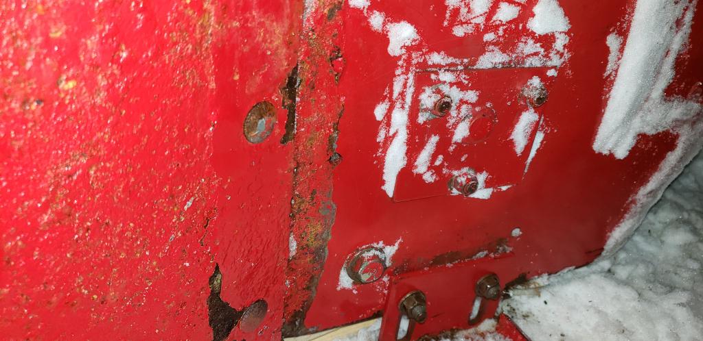

Tom kite 3 #8 Posted December 5, 2019 Have a wheelhorse 32' snowblower old .Have way to .make and adjustment here a pic Share this post Link to post Share on other sites
peter lena 9,280 #9 Posted December 6, 2019 i agree with others above on the 1/2" of chain play , yes checking over those sprockets is vital along with chain wear, i also use a SERATED WASHER on the bolt adjustment slot , assuring that your adjustment will stay. i regularly lubricate my blower drive and all related movement points with chain and cable lubricant , i do it before and after usage , assuring constant lubrication. my blower auger spins by hand , and my belt pulley spring frame is lubricated also to insure the belt tension is constant. use a polymer based spray in your chute and auger area for easier blowing. also lubricate your chute base and cable for easy use. good luck with it , pete Share this post Link to post Share on other sites
