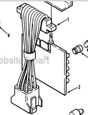

Model 73420 (1995) wiring harness from test switch to system. Can not find anywhere as I have some broken connections. Anyone know of source for this?

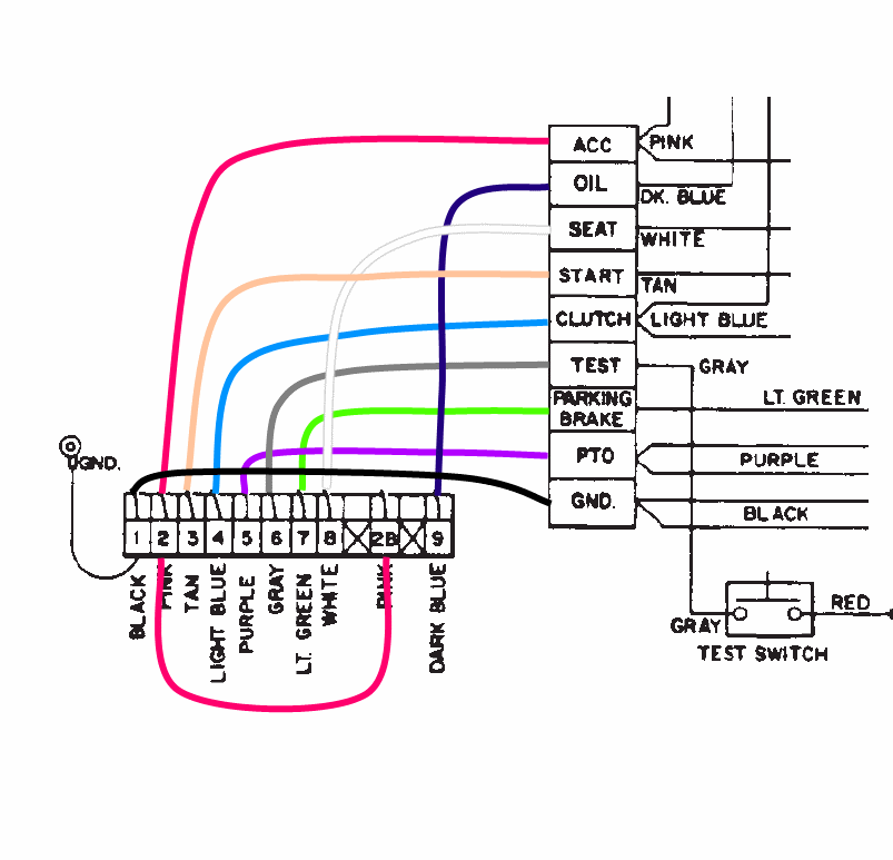

somewhere on this site i posted reverse engineered schematics i created a year or two back
let me do a search and check
Does your system have the 9 pin connector leading to the circuit board?
If so, a simple switch to apply 12 volts to the grey wire on pin 5 of the circuit board connector is all it takes.
