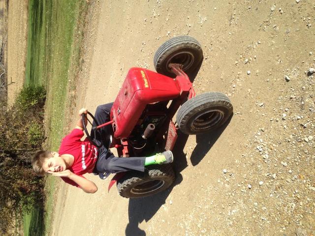

Tjf 18 #1 Posted October 26, 2015 MY BOY HAS DECIDED TO BRING THIS HORSE BACK TO LIFE FOR A 4H PROJECT. WE FOUND IT IN A BARN WITH NO PRIOR HISTORY OR KNOWLEDGE ABOUT IT. CAN ANYONE HELP ME WITH YEAR, MODEL, ANYTHING ELSE I NEED TO KNOW ABOUT IT? I HAVE NO IDEA WHERE TO START. WAS THERE A SPECIFIC COLOR FOR BODY AND WHEELS? WE WOULD LIKE TO PUT IT BACK TO ORIGIONAL IF WE CAN. ANY HELP AT ALL WOULD BE GREATLY APRECIATED!! 12 Share this post Link to post Share on other sites
953 nut 60,008 #2 Posted October 26, 2015 From the picture I can tel you it is a 1961 Suburban. Not sure of the model (401 or 551) would need the see the transmission to know. 4 Share this post Link to post Share on other sites

evanloock 236 #7 Posted October 26, 2015 It's a 1961 551 as evident by the throttle/choke controls type/location and the angle iron hood stand. 1 Share this post Link to post Share on other sites

Tjf 18 #10 Posted October 27, 2015 (edited) I want to thank everyone of you for helping me! I've learned more in the last hour than the last 6 months of owning! Couple more question: what's not factory on it? I had to replace the starter, cables, and key switch so I know those. What colors are factory? I've seen white tires and cream. Would it be bad to change frame color to black? Red frame and nice "car finish" red paint with clear coat? Any idea on value of tractor? Where should the key switch go? What goes in the hole that is in the "dash"? I know some of these questions might be like asking what company made a better pickup but I value your opinions. Where there any "demo" models that came out in different colors?again THANK you all! Edited October 27, 2015 by Tjf Share this post Link to post Share on other sites
RedRanger 1,469 #11 Posted October 27, 2015 (edited) Definitely a 1961 suburban.Agree it's a 551 if electric start and it does look to have a battery, so it probably is.Current value-depends on location and buyer and condition...$300-$400 as is?Is the engine original?Missing correct exhaust and heat shield, hood has minor mods to it, foot pads are incorrect. All minor changes.Looks to have original tires.Post up some better pictures of all sides. Nice tractor.It's your ride, do it up how you like.Nothing wrong with changing colors.Would have had off-white rims and seat with red everything else from the factory.IH/Case red and antique white work well if your spraying with a gun. If you're using rattle cans, a lot of people like regal red from rustoleum.It's future is in your hands. Edited October 27, 2015 by RedRanger 4 Share this post Link to post Share on other sites
Tjf 18 #12 Posted October 27, 2015 Yes engine is factory lauson. Do you have any idea on where to purchase heat shield? I would like him to have that so he doesn't burn his leg Share this post Link to post Share on other sites

RedRanger 1,469 #14 Posted October 27, 2015 Yes engine is factory lauson. Do you have any idea on where to purchase heat shield? I would like him to have that so he doesn't burn his leg Originals are hard to find, but repops can be had on Ebay for under $50. Average person would never know the difference.First thing I'd do is change the exhaust. Agree. Share this post Link to post Share on other sites

Racinbob 11,929 #17 Posted October 27, 2015 While I love these little tractors being original keep in mind we aren't dealing with a numbers matching 1970 Hemi Cuda vs a slant 6 cloned to a Hemi. Besides, if you ask things like what was the original (whatever part) to 10 people you'll likely get 12 answers. Some parts have numbers cast into them so they can be verified from the parts list. Like others have said, the exhaust needs to be worked, the hood has some extra holes and the key put back where it belongs. The footrests are very functional but nothing like the originals. It looks like they are held in place like originals so it will be an easy fix. Decals are available from a vendor here, redoyourhorse.com. Don't forget the mechanical stuff. I'd drain the transmission and it it needs it, flush it out. Make sure the seals are good. Service the engine. A reproduction belt guard and exhaust shield will be perfectly fine. Most importantly, just have fun. 3 Share this post Link to post Share on other sites
