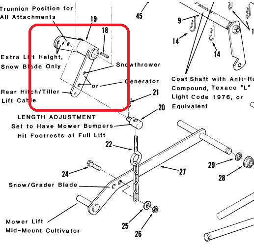

1978c81 385 #1 Posted October 25, 2015 Looking to purchase a blower. Gentleman doesn't know what comes with the dual stage blower. Question is how does the blower lift. Does it have a lift pole like single stage? Share this post Link to post Share on other sites
gwest_ca-(File Mod) 11,512 #2 Posted October 25, 2015 I believe this was the first 2-stage Wheel Horse snowthrowerhttp://www.wheelhorseforum.com/files/file/2926-snowthrower-44in-1990-2-stage-06-44sc01-om-tipl-snpdf/Before this Bervac supplied the 2-stage units but not that common.Garry Share this post Link to post Share on other sites
rokon 64 #3 Posted October 25, 2015 It has a lift bar that goes to a bellcrank linkage that sits in the front attatch-a-matic bracket. Sort of a compound leverage arrangement because the blower is so heavy. Share this post Link to post Share on other sites
1978c81 385 #4 Posted October 25, 2015 Does anything attatch to the lift arm? Share this post Link to post Share on other sites
wallfish 18,195 #5 Posted October 25, 2015 Download the file which Garry's link is to. It will show ALL the parts Share this post Link to post Share on other sites

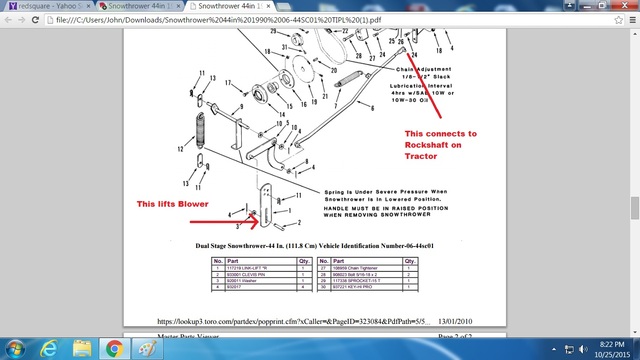

1978c81 385 #6 Posted October 25, 2015 I'm still confused I guess on how the blower lifts when you pull the hydro lever. Share this post Link to post Share on other sites
wallfish 18,195 #7 Posted October 26, 2015 (edited) It's a bit different than a sinlge stage Edited October 26, 2015 by wallfish Share this post Link to post Share on other sites
mikekot3 93 #8 Posted October 26, 2015 What is the rockshaft? Is that the deck lift mechanism on a manual lift tractor? Share this post Link to post Share on other sites
1978c81 385 #9 Posted October 26, 2015 Wallfish awesome thank you Share this post Link to post Share on other sites
wallfish 18,195 #10 Posted October 26, 2015 (edited) Should have said Bellcrank Edited October 26, 2015 by wallfish Share this post Link to post Share on other sites
